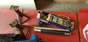

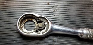

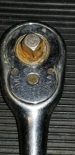

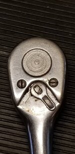

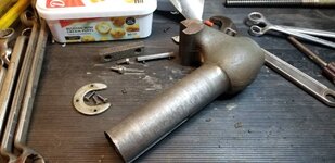

I spent one particularly cold winter Saturday in the heated garage rebuilding an Indestro 6672 1/4" ratchet.
fd95069456350444bd1805392b3e0b64.jpgc145a1e3939766bc75e4225ba223f993.jpgbfd42fe598e398c4d72253a2b06240de.jpg
This one was pretty easy to disassemble, and there were no sneaky springs that went sproinging out across the workbench.
The parts were not worn out, just gummed up with old grease, so I just cleaned and re-lubed everything.
After re-assembly, it definitely worked better, but still not as smoothly as others I have.

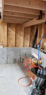

Another long-time goal of mine has been to install a powder coating oven in one of my garages. Over the years, I have saved two different kitchen stoves from rental properties, but never got around to putting them in. However, while home over Christmas, my Dad let me bring back the vintage GE double wall oven he had bought with the same purpose in mind and with the same lack of completion. It has been cluttering up a corner of his shop for several years and now that Parkinson's has deprived him of his shop time, he was happy to see it put to use.
I decided to tuck it into the far end of the storage mezzanine, opposite the entry door.
Just like behind the workbench, I insulated and sheetrocked the wall, but not before adding a junction box to the 240V circuit running to the welder outlet. I wanted to keep the floor below clear, so I made a partially hanging box from scrap 3/4" plywood to enclose the built-in wall oven.
c1c1081704184e12eb6d4043cd9fcaa2.jpgc2815d44e37ca38c9d15fdba0c8a9524.jpg44b2cb89e709ffde2dcc903564af120e.jpg
Here's the oven after final install. Note the 2x trim piece on the front--it serves several purposes: 1) my scrap plywood wasn't wide enough to allow the oven to slide all the way in, so I needed to cover the remaining 2 inches, 2) the screw holes on the front face of the oven (that prevent the oven from falling forward out of the hole) were too far in to allow screws to bite into the vertical plywood. So, I spent some time on the table saw shaping a 2x4 to the dimensions needed to fill the gap.
The space to the right of the oven will eventually get turned into a powder coating station. I'll probably use some of the remaining oak boards I have to assemble another butcherblock work surface.

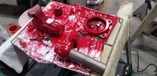

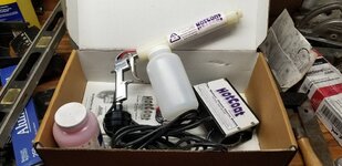

But, being the impatient person I am, I couldn't wait to try out my new equipment. I disassembled this 1978 Wilton bullet vise that will eventually be mounted on the new garage butcherblock bench.
After some bead blasting in the blast cabinet, it was ready to go. I cracked open the yard-sale-found Eastwood powder coating kit I've had for a few years. All of the original receipts were in the box--this kit was bought back in 2006 and never used.
I wrapped the oven grate in aluminum foil and selected Mirror Red from the powders that came with the kit. I sprayed down the parts with degreaser and after letting them dry, hit 'em with the powder gun. It worked okay, but despite Youtube video warnings about the difficulties in getting into tight spaces, I still managed to miss a few key areas under the static portion of the vise. I also had a few areas where the powder didn't stick, probably due to contamination. A recommended technique that I skipped is to bake the part before putting the powder on to drive out any trapped oils. Maybe next time.
fec8318416f58cf1e87220ba9a2e7fd1.jpgac51c51f570b29eb5105af33ddfb3182.jpg366d1c11317e030f82a7e5eeef644511.jpgb6b473f09b399e761889212ed1c4db74.jpgdab6f449468c1efd8774e28ca04c4f9e.jpg4e3c96f255aaca61b5d1ed71884702e2.jpg

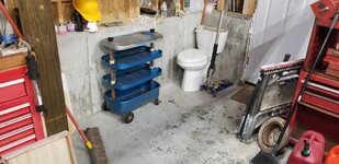

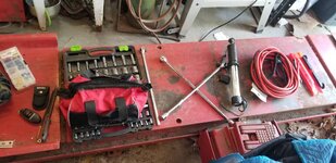

Finally, since I put my lift into service, I've been wanting a tool cart to set wrenches and parts on as I work under the car. After haunting Craigslist and looking at carts on Harbor Freight, I recalled that--duh, I already own a Hazet-imitation cart that was tucked under a bench in the other building gathering dust. I pulled it out...and remembered why I had tucked it under there in the first place: one of the latches was broken. Nevertheless, since I had it out, I decided to repair it.
Here's the corner where the cart will live. Of course, the first step was to clean out the junk already there. Oh and no, the toilet is not functional--it was salvaged from another renovation and will eventually go upstairs in old garage as part of an efficiency apartment upgrade.
The problem with the latch is that the cheap sheet metal finger grip had pulled off of the locking pin. That fix was easy: I tapped the sheet metal back onto the pin and swedged the pin metal to re-grip and capture the sheetmetal. I then needed to take the entire bracket off of the shelf to get the clearance to reinstall the repaired part. That task involved drilling out the blind rivets, punching them through, installing the part, re-installing the blind rivets, and the swedging what was left of the ends to capture the bracket again. I was doubtful the repair would work, but so far it is holding.
f7fb4ec45c3e026e2477fbebd4718ad9.jpg8790fecf8035b5f37007f21dd9358559.jpg35ec4adc11fa5ccc2834a985cca998c5.jpg

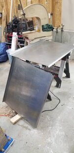

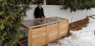

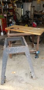

One of the Life Scouts in our troop asked if he could build his Eagle Scout project in one of my garages. I said yes, in part because it forced me to clean up for company! He built a cedar composting bin for the church that sponsors our troop, and it turned out really nice. We had about 30-plus people come by over two weekends, and it was fun to share my spaces and collections with my scouting friends. cbb9408fa03a4084fbe39a82a8f2f598.jpg47c02633e0fbde9b017c6dedd33e149f.jpg
Yesterday, I worked on making a workbench next to the powder coating ovens. I added an LED shop light, insulation and drywall.
Next, I turned to the work surface. I've been wanting a stainless steel bench for a while, and I finally spotted an affordable utility table on Facebook market place. Here's the 6-ft table surface upside down on the saw horses. I was impressed at how substantial the structure was underneath.
I cut the underside braces first, and then flipped it over and cut the top.
After some trimming, here it is installed. The vises in the pics had just come out of the oven. My learning curve continues...

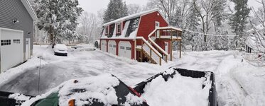

Eight inches of snow on the ground, schools and work are closed....time to start clearing the driveway!
B
BlueBomber
Sep 14, 2013
3,201
Outside Boston, MA
Aaaaaaand Done! The plow makes for quick work of it.3e00bf1c1daf2c515dc273d416e1153a.jpg

BB: how do you like the finish of the powder coating except for the few flaws you mentioned?
i've always wanted a dedicated shop oven and I actually bought one to use as one before my landlord got a divorce and needed to sell the shop I was leasing. since we won't be moving now for maybe 10 years I sold my vintage oven to a couple that remodeled their new kitchen around it. I never thought about putting a cabinet type oven in a garage and good to see you made yours work ok.

Drives: the finish is not bad, but I've only coated cast surfaces so far. When I get some more jobs with smooth metal, I will post some close ups.
Your stove looks like it had a huge oven space, a significant limfac in my installation. I only have a roughly 18 inch cube to work with. I've seen some tricks online where you can leave the door down and fab a cover that effectively doubles the volume of the heated space. If I come up with anything that big that I want to coat, I'll give it a try.

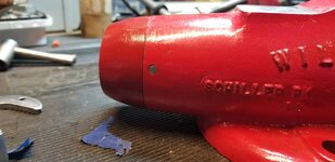

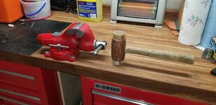

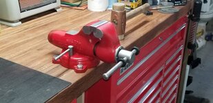

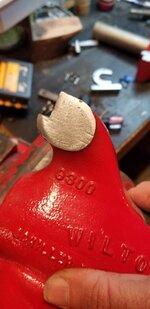

Today, I culminated two different project, one about a year older than the other. First up was the restoration of this Wilton 9300 bullet vise.
I bought it a little over a year ago at an estate sale only a few miles from my home. It sat for a long time, as I wanted to strip it, powder coat it in an oven I had yet to set up, and bolt it to a workbench I had yet to build in the new garage. Well, now that I have powder coating oven installed and the bench done, the Wilton's time had come.
I used my homemade blasting cabinet to bead blast the Wilton and then powder coated the exterior parts, which I showed in an earlier post. I sanded out some flaws in the first coating and re-coated the vise, along with another vise I had stripped long ago and which was cluttering up a workbench. The second coating on the Wilton was not perfect, but better, and since this would be a working vise, not a show queen, I decided "good enough" had been reached. Today, I put it back together.

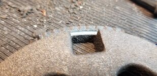

First, I used an orbital disc sander to smooth the shiny flat surfaces. Yes, I know the clear area on the tail piece is not meant to be used as an anvil. I left it bare for the inevitable "minor" percussive persuasion activities.
daa04eaed168c1c54e8b80cf9b57fbfa.jpg4f43acd56ef88c6a2de67b4342734ee1.jpge8d97e6c7e6a15eb4d9adbbf46e803b6.jpg

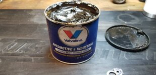

Next, I lubed and remounted the main screw and end cap, and then drove the pins back in.

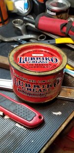

I found this nifty can of Lubriko Grease previously at a sale and put a big plug of it in to lube the screw.
After assembling, lubing and mating the movable jaw to the base, I did the same to main screw, retaining plate and the swivel plate. The jaws of the swivel plate lock the vise positively to the base, and mine were relatively unworn.
Here she is, completely reassembled!
I dug into my stash and found exactly four fine thread 1/2-inch bolts of the right lengths, with nuts and washers. I had to run a 1/2 drill bit through the mounting ears of the swivel plate to knock out a few thousandths to make room for the bolts. Finally, I carried the vise over to the new garage, and after carefully centering the vise, I drilled the holes and mounted it.

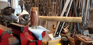

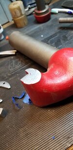

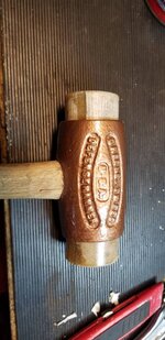

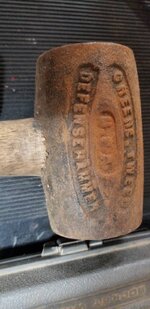

The other project I finished this weekend was the restoration of a Greene & Tweed No. 4 Defense Hammer. I picked this up late last year, rusty and missing the rawhide inserts. I recently found some replacements and they arrived last week. Here's the original hammer:
And here it is after a bead blast treatment:
I masked off the handle and the top and treated it to three coats of Rustoleum Hammered Copper. After drying for an hour or so, I smacked in the new rawhide inserts.
e7391adac6de0ab64fba537f74203459.jpg90540965edcc41bdcc72cc9b658927e0.jpge8c706baf1961d41b9897e1ebf88c84e.jpgf4ba0e3feb3fcc01fc2f8b09f1b286ff.jpg
Here are the two weekend projects together!

Cool Bullet! Just an observation from the cheap seats here, but I'd bet the little defects you have could have been eliminated if it had been outgassed for a few hours first before you blasted and coated it. It probably had some old grease or oil on it that soaked in over the years.
Keep up the fine work!

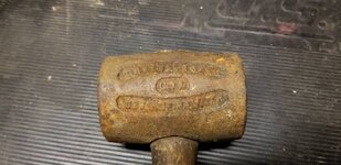

So after finishing the Green & Tweed No 4 Defense Hammer a few weeks ago, I felt a compulsion to own the other two sizes, the No 1 and No 3. Ebay enabled my impulse and I soon had two rusty examples delivered to my door.38cec070c6dc003bd04b421c925307e6.jpgd6f2b629fc5c8a93a0948d4766d814b5.jpgbd0143b57c616e840bc90b66ee5c4a10.jpg
I gave them both the glass bead blast treatment to remove the crust. Here's the No 3 after exfoliation.

Next I masked the handle on both sides...
...and gave them the Hammered Copper treatment.
Here are all three. I have rawhide inserts from Garland on order for the two smaller hammers that should arrive in another week or so.
6e354b402f804c2717b4816a5bac6000.jpg5e7499258063d1a88a2cea2ae4346171.jpg2f1bb1cc4ae186d9c1fbb7f4f0da5101.jpg
As far as I can tell, there was no No 2 Defense Hammer by Green and Tweed. They did make a split head No 2 but that's a different hammer. So, I consider this a complete set!

They were made to be non-marking hammers for aircraft and body manufacturing and repair.

My latest addition to the garage was a Craftsman power hacksaw. I scored it as the diamond in a big estate sale auction lot of mostly junk.
Also in the lot was the butcher block topped angle iron work bench in the above picture. Unfortunately, the bench is too big to fit in either of my garages, so I decided to make my own mobile platform from other stuff I had around the shops.
I had saved the mobile base from a scrapped Craftsman radial arm saw, but it was also a bit big, so I decided to narrow it by 3 inches.
First, I unscrewed the top from the old bench. Then. I unbolted the Craftsman base on its narrowest sides and trimmed all four pieces of metal. The beauty of these universal bases is that the holes were already aligned, even after my trim.
Next, I cut the butcher block down so that I would have an equal 4 inch overhang on all four sides. This allows the angled legs to mostly stay under the table top.
I marked and drilled mounting holes for the hacksaw and found hardware from my stash to bolt it down. I intend to drive it with a motor under the table, so I cut a slot in to top so the belt could drop down below.
More work to follow, but that's all I had time for today!8059b5afb6f3ee0f9fe0b00756969717.jpgc433b41184723ec2c0fe6c723a501e82.jpg

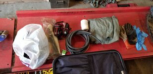

Today I depart on a business trip. This one has a twist from my usual travel: I'll be driving back in a classic car!
As some of you have noticed, I have a white 1960 Impala 2-door hardtop, seen in background pics on this thread. Here it is on the day I brought it home:
She's complete, but a total rust bucket. I've stared at her for two years, putting off starting on metal repair knowing that I'll have years of it ahead of me before I can drive it. Well, SWMBO told me a few weeks ago that she'd much rather I have a car I can drive than one I need years to finish. I think that's her way of saying she'd rather spend time with me, and not in the garage with me! So, after looking around, I found a finished car that is in my price range.
The plan is to fly into Des Moine, Iowa on Friday and check her out. I had the dealership send me pictures of the undercarriage and floor boards, and they all look good. If the car is everything I think it is, I'll sign the papers and start driving her home via Dayton, Ohio (another business meeting) and Culpeper, Virginia (my parents).
Now, I realize driving a 59-year old car I've never seen 1700 miles has an element of risk. Okay, several elements. This car has been sitting a while, so there's a big risk of systems failing along the way. So, I planned my trip east to end on the first day at Thomas & Chris Payne's garage in Philo, IL. For those of you who don't know the Payne's, check out THE most popular garage on Garage Journal. I PM'd Thomas asking if I could stop in and get a brief tour of his garage, and being the friendly midwestern guy he is, he offered the USE of his garage if my jalopy needs any work!
Meanwhile, I packed a bunch of tools to hopefully help me avoid getting stuck on the side of the road somewhere. Here are the pics of the equipment I layed out for packing.
1dd59d9ac9469cf8a4fd6b525b747566.jpg6c1cb308e82fe5c82f90ca6b0cfc5c3e.jpgdc135a96a43b415df4258c4dd20a63b3.jpge239b91b823c16d8510e5923dc8bf95b.jpg
I also plan to buy a bunch of stuff in Des Moines (fluids, fire extinguisher, other supplies, etc) to help address any problems I might have.
Wish me luck, folks! I'll chronicle my purchase and journey in this thread as I go.
