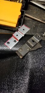

So let me go back to late August. I did get the carpet and seatbelts reinstalled in the T-Bird and SWMBO took it out for her first drive behind the wheel. That cemented it--the T-Bird was --hers--. When we bought it and I told her it was for her, she said "yeah, right." But once she turned the key, heard the burble from the exhaust and motored down the road in it, she fell in love. It was good to witness.
Once the Bird was out of the way. I moved the Impala over and began work on installing shoulder belts for the front and lap belts everywhere else. Like the T-Bird project, I started out taking pictures but stopped about halfway through.
The two door hardtop design makes shoulder belts a bit harder to install. I didn't want to put the shoulder belt up in the roofline, as that breaks the aesthetic openness of the hardtop. Going straight over the back down to the floorboard doesn't work either for a number of safety and mechanical reasons. I pulled the interior rear trim panel and examined the sheetmetal structure of the section behind the door, and it seems as robust, or more so, than the floorboards that would serve as anchor points for the other ends of the belts.
So, for the shoulder belt, I modified a bracket from the kit I bought and welded it into the quarter interior. The bottom belt reel was mounted via several bolts lower down and is hidden behind other rear seat structure.
Be assured, I used grade 8 hardware, large fender washers behind sheetmetal floorboards, and even after that, I'm under no illusions that my 60-year old car is now as safe as a modern car. However, it is way more survivable now than it was when I bought it, with NO seatbelts at all.
I only got the driver's side done, and found that the belt doesn't move freely. I can see why, though, and when I take the back seat back out to do the passenger side, I'll tweak the design.

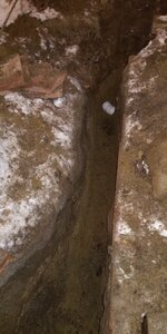

Next came the saga of the sewer line. See, when I renovated the garage back in 2014 and put in a new slab on the ground floor, I had the workers stub in a 4" PVC pipe into the floor and through the foundation. I extended that stub to the other side of the driveway before I had it paved (back in Post #51). The plumbers dug down two feet and couldn't find it, so I rented the Kubota again on Halloween after work and opened up the trench in an evening. Here's the "before" picture...I forgot to grab an immediate "after"...but don't worry, the trench is still open as I type this.
Turns out the pipe I stubbed in 6 years ago was too deep. It couldn't gravity feed into the existing septic system. My plumber consulted with "someone" in the building department and determined we could put a pump tank in the ground beside the driveway to macerate the sewage and lift it up the extra 18" needed to allow it to gravity feed from there. So, over a weekend, I excavated a hole six feet into the ground and bought a basin and a big Liberty sewage pump. I also extended the trench by hand to the side of the house and ran electrical conduit out to carry power for the pump.
Getting a hole through the side of the sill was a bit of a challenge. I had picked up a giant 7/8" diameter auger bit more than a foot long at an estate sale, and the sill beam on my 100-yr old farm house needed every bit of it to break through. From there, it got even more fun. Sometime in the house's past, someone had poured concrete inside the stone foundation walls in an attempt to dry out the basement (it didn't work). However, that left the walls over two feet thick in paces, which meant the first floor joist in from the sill plate was also above the foundation (and running parallel to the wall), thus blocking access from the inside to the hole I had just drilled on the outside!
I ended up digging out the longest spade bit I had (14") and an extension (another 14") and just barely had enough length to drill through the floor joist...from the outside! Then, with the drill bit still in the hole, I taped a fish line to the drill bit, pulled it back through to the outside, taped the electrical wire to the fish line and then pulled the wire back through to basement. Whew!

All seemed well. The plumbers laid in the pipes inside the building and down the trench from the basin to the main line coming out of the house, and then called for an inspection. However, this time a different "someone" came out and said "No way can you have a pump tank in the yard! It has to be inside a building!" Grumble--growl. So, I had to rip out all the plumbing and conduit from the trench and my son and I hand dug it another 18" deep over the 50-ft length of the trench.
We lucked out and avoided any big rocks until we got up close to the foundation. Yeah, there were lots of big potatoes from when they excavated the basement. The first big boy required some creative jerry-rigging. I wish I had taken some pictures--we parked my pickup truck nearby in the driveway, ran a tow strap from the tow hitch to a come-along, connected a logging chain to the come-along and ran that over several 6x6 scraps at the edge of the hole and then down and around the boulder. It was a little sketchy, and I had my son run the winch while I was down in the hole near...but never under!... the rock. After a few incremental lifts and some shoring to allow repositioning of the strap/winch/chain, we eventually got it up and out of the hole!
Here was the trench just before the new year, with the pipe partially laid in.

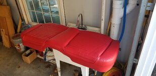

My wife and I also tackled reupholstering the seat in her '57 Thunderbird. Neither one of us had ever done more than stretch-over seatcovers, and this was a little intimidating. We got the bench stripped down, and then it sat in our living room for a month before I finally got up the time and courage to put it back together just today. I also stripped down the seat back and prepped it to go back together later this week.

But before I began the wall board, I had to modify the vanity junction box bracket to clear the vent pipe. The vanity light needed to be centered over the sink, which put it in the middle of the stud cavity. It will be pretty heavy, so I wanted to use a special junction box with a bracket that anchored to either stud in the wall cavity. The problem was that the plumbers routed the vertical vent pipe up through the same cavity. They did bend the pipe around the spot that I wanted the box (centered over the drain) but the pipe itself blocked the bracket. No problem...I have a cordless cutoff saw and a welder. In about 30 minutes, I had the shape I needed.

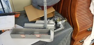

I also worked on the sliding barn door for the bathroom. I picked up a commercial solid core door off of Marketplace for $50. It is a monstrously heavy door, and at 41" x 79", too wide and too short. However, the price was right, and since I plan to paint it, a little surgery will allow me to resize it and fix its flaws.
I removed all of the heavy duty attachments, including the hinges, latch and automatic door closer. These should come close to covering my acquisition cost on Ebay.

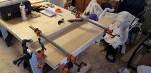

The first task was to cut the door down to the 36" width I needed. The door has a particle board interior with birch veneer and edges, the first step was to remove the edge off of the door knob side. I then cut another 5-1/2" down the length of the door to remove the door knob hole. In both cases, an 8-foot scrap of wallboard edge served as my straight edge. Although not pictured, I later glued the edge back to the side of the door and held it in place with panel clamps until it was solid. I also brushed sawdust into the gaps and glue to help with the blending and sanding later. Later today, once the hardware kit arrives, I'll cut an extension for the door bottom and glue it on, too.
On the door hinge side, a 1/4" slice removed the hinge mortises, leaving only the screw holes that wood putty should fill in nicely.

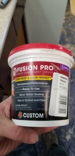

Next, I grouted the stone & glass mosaic tiles with a grey-tinted premixed grout and a rubber spreader. I pretreated the mosaic with a grout release, and it seemed to work well. I wasn't sure my little container would be enough for my 6-in x 10-ft strip of mosaic but I had some leftover at the end.

The plumbers finally hooked up the water and drains, so I tried out the hot water heater when I got home....nothing! I did some troubleshooting analysis and got worried when I found a warning that said not to turn on the heater unless water was connected. The risk was burning out heating elements--d'oh, I had done just that when I first wired everything up! However, after further inspection and reading, I found the problem:
Yep, the plumbers hooked up the lines backwards! Turns out these electric heaters don't heat when you run the water through them in reverse (imagine that).
The plumber fumbles continued, unfortunately. After coming out to fix the connections and prep for final inspection, I got a text saying the heater (which I had picked out) was too small and not producing enough heat at the shower head three feet away. Another end of workday inspection revealed they hadn't flipped on both breakers that feed the heater (2 40-amp 240V circuits). After doing so, it heated just fine. So, they scheduled and the work passed the final plumbing inspection. I was just about to send a "thanks for everything" text until, on a hunch, I checked the attic to find this:
The vent pipe was not appropriately through the roof. Both inspector and plumbers had missed that! After sending the same picture to the plumbers with a a "this doesn't look right..." note, they quickly came back out and and, finally, finished the job.

This weekend, I made a commitment to SWMBO to get her Thunderbird seat finished and reinstalled. With spring weather fast approaching, she was getting antsy to get her car back on the road.
First thing I did was make some room by putting back up a shelf that came down to allow access for the electrical work on the upstairs bathroom. Easy peasy.
Next was finishing the upholstery work on the seat back. I left it with the central parts hog ringed in and needing to fasten the top, bottom and sides. I started with the top, and used a wooden scrap and clamps the help compress the new foam so that I would have enough material to staple and hog ring. It worked, and I plowed forward with the rest of the work. I never imagined I would have to trim so much foam away from a kit specifically designed for my car, but I sure did. At one point, I test fit the seat back to the bottom and realized I needed to open it back up and cut off some more foam so that the seat would fold all the way open!
All proceeded reasonably well with no damage to my new upholstery...until I got to the last step of putting the backing on. With the new vinyl obscuring the old holes in the seat frame, I elected to drill new ones. Unfortunately, while driving the screws into the new holes, the screws occasionally bound up, making the driver slip a few times, poking a few extra holes into the brand new backing. This was annoying, but the curse words flew when the bit slipped and tore a 3/4 rip into the brand new vinyl upholstery, right at the top of the driver's side seat! Grrr! I ordered a vinyl repair kit from Amazon--hopefully it will minimize the problem.
Once the seat was done, I replaced the air distribution plenum under the dash while I still had room to get easily up under the dash. The original was pressboard, and had deteriorated and torn. The replacement from NPG was plastic, and will live forever, but I was not impressed by the flimsy metal brackets that were attached. I drilled out the rivets on both pieces and reattached the old brackets to the new plenum and then put it into place, followed by the seat.
363cbeb4ed0062d3b66dd07f8f234451.jpgc3a556c1e5c09ab81e40897dd2a13175.jpg9008f5404a4184d90e89f2d83263e314.jpg
