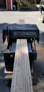

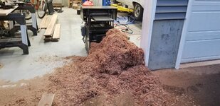

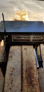

After putting a new set of handles on the wheelbarrow (only had them on hand for two months!), I decided to have a start at planing down the old oak fence boards I'm going to use for my workbench surface.

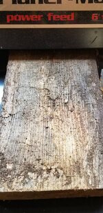

These boards had been sitting out in a field on my parent's farm for nearly 15 years. They were under a tarp, and so somewhat protected from the weather, but the tarp also held in the ground moisture. The boards had started to rot, and my Mom wanted them in the dumpster. However, as my son and I started to go through them, I saw many of them, though covered in fungus and mildew, still had solid wood. I cut the 16-ft boards in half and filled my truck bed for the trip back to Mass.
I ran the first board through the planer, and it cleaned right up. It also put all that mold and fungus in the air for me to breathe--not good. I stopped and got some safety equipment on.
Much better. I ran about 14 boards through, planing both side and taking the boards down to a uniform 3/4" thickness. This was my first big test of this estate sale-scored Craftsman planer, and it handled the boards just fine. It could stand a new pair of feed rollers, but otherwise, I'm impressed.
The planer made a huge pile of shavings, and this is only a quarter of the boards I have.
I think I'll take the boards I planed and go all the way to butcherblock with them to see how well it will work. I'll split the six inch boards in half lengthwise, and after cleaning up the edges, I should end up with a bunch of 2-3/4" x 3/4" x 8' sticks. Then I'll square the ends and start assembling a ten-inch wide by eight-foot long chunk of butcherblock.

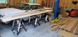

I found my Saturday afternoon unbooked so I put some more work in on the workbench butcherblock.
I went thru the 3/4" x 2-5/8" boards and cut out any sections that had significant rot, either thru more the 10% of the thickness or on the face that would be glued. I also cut out any flaws like knots and cracks. I was left with a bunch of 8-footers that needed no trimming and a bunch of "scraps" lengths from 12 to 72 inches.
From here I started laying out the butcher block, alternating full 8-footers with two scraps cut to add up to eight feet in length. I also tried to alternate the **** joints from left to right so as to spread the weak points around. I was able to dry fit two 10-in wide by 8-ft long sections of workbench top before I determined I would not have enough to finish.
So, back to the planer I went. After another couple of hours, I planed about 15 more fence boards. Nearly all of these boards yielded good, healthy oak with little sign of wood rot. I hope to rip them in half like the others in the coming week and get started at gluing them together.e5a032ea2b6cb46ff28c6d8f120d5808.jpg1281e63174f9a6f5f22d88f76de1f00e.jpgdf803f0e6ffe5ec2b5270f50e23a10b1.jpg

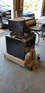

The big Craftsman planer's feed rollers are deteriorated and are slipping quite a bit trying to feed these dirty, scum-covered boards through. After surfing a bit amongst the various Sears parts sites, I was delighted to find that the OEM, The Belsaw Company in Santa Clare, CA, is still in business. They have a web store, but I called to order the parts. I spoke with Jim, who was a delight and full of helpful advice on other wear items besides my two roller feeders. For $130, I have two new rollers on the way and a helpful resource if I should ever need anything more.

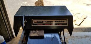

So I spent today putting more time in the garage on the work bench lumber. I decided to go ahead and plane down all the remaining oak fence boards, about ten, that I had hauled up from my parents' place in Virginia. They were cluttering up a corner of the new garage, and there were still bugs living in them. Literally. I had to shake off a bunch of rolly pollies so they didn't meet their end in a ride through the planer.
The big Craftsman/Belsaw planer is a beast. I started feeding single boards through...
...at 1" thickness and then made multiple passes on both sides down to 3/4".
Here's a rotted, fungi-filled board going in...
...and this is the same board out the other side.
Then, I decided to try two boards at the same time. The Beast didn't even grunt...hahaha, what an animal!

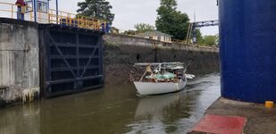

Thanks, gents! It was a lot of fun, but as if 6 days and 360 miles wasn't enough....
...my "little girl" asked her brother and I to run a Spartan Beast obstacle course race with her that very next Saturday (the day after we finished the ride). It was 13 miles up and down the ski slopes at Killington, Vermont. We finished and had fun, but I could barely bend my legs for three days afterward!
Here's a link to a description of the race:
https://www.spartan.com/en/race/detail/3618/overview
aand here are a few pictures...
View media item 87046View media item 87047View media item 87048

Finally got a chance to spend the day in the garage working on the workbench top. As Drives indicated above, the many weeks since the last update allowed the oak strips to be bone dry--perfect condition to begin gluing them together.
My first step was to set up a temporary workbench. Some extra 12-ft 2x6s and three saw horses did the trick.
I started with a line of glue and used a scrap block to spread it out to maximize contact and minimize seepage out the edges.
Then it was stack, straighten, tack with brad nailer, and repeat. I decided to make my slabs 7 inches wide to be more managable to move. Once a full stack was done, I clamped it down as tight as I could with various pipe clamps.
Despite my best efforts, I still ended up with a few gaps between boards.
I also had a little cupping that the planer will take care of. I now realize I should have alternated my clamps top and bottom to minimize any cupping due to clamping. However, I think most of the height difference is due to not getting a consistent stack as I went along.
Good thing the window is out of the Impala driver's door! :)
Here's the second slab clamped up.
At this point I realized I wouldn't have enough clamps to independently clamp all four slabs, so I started laying them out on the floor and clamping each subsequent slab to the first. I put the slabs aside to dry overnight and turned to another project I've been wanting to make for a while--a mobile cart for my big planer.
You see, the planer is a heavy beast and is awkward to get out of it's corner and set up for use. Plus, it puts a ton of dust in the air, so I'd like to be able to move it out into the driveway when I need to use it. So, I dug into my stash and managed to find everything pictured below either in leftovers from prior projects or in buckets of stuff I've brought home from estate sales for cheap.
I made the base frame out of 2x6s. I wanted to elevate to planer a bit, as I found myself hunched over a lot when using it at the factory height. I used the biscuit joiner to add strength to the 45-degree corner joints.
I swear I took more pictures than this, but it was getting late and I was rushing to finish the cart. I created two hinged wheel boards that can fold down and lift the platform about an inch off the ground. The wheels are four casters with a locking brake on each. The hinges were also out of a stash of sale finds. The board is held down by a hinged strut, connected to another strut, that is screwed-and-glued to the frame. When the wheel boards drop down, the strut swings in and holds it in place.
The next morning, I used the lift to get the planer up high enough to slip the platform under it.
However, after horsing the planer around the garage, I decided the little glued-and-screwed 2x4 corner platforms would not be substantial enough to support the planer feet, so I cut some 4x4 scraps and attached them under each platform with another four deck screws per block.
Much better...
Here's the moment of truth....and it held!
It also rolled around just fine. However, after the glow of accomplishment wore off, I realized I needed to figure out how to lower it to the ground so I could plane my slabs! A slick built-in pivoting mechanism may be in the future, but for now, it was time for the giant estate sale pipe wrench to find an additional purpose.

On to planing! First, I flattened the bottom of each slab.
Then I planed the top of each of the four slabs.
Overall, I'm very pleased. The slabs planed down great and will have a lot of character. I am open to suggestions for how to handle the gaps between some of the butcherblock boards. I could squeegee wood glue down into them, and then sand down the surface to get back to raw wood for the BLO finish I plan to use. Any other methods you all would recommend?
