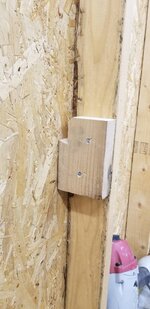

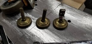

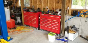

Finally got a chance to get back to workbench construction. Here's the starting point. The workbench will be about 30" deep, from the wall to the front of the 6x6 columns, and stretch between them, a total of eight feet long. The two tool chests are Harbor Freight 44's and theyll be built in. Therefore, the first thing to do was remove the drawers and lay one down to...
...remove the wheels. These are pretty impressive rollers, fully greasable and with robust brakes. I'll definitely keep them around for a future project.
The next task was figuring what to do with the wall at the back of the bench. I decided I didn't want to stare a bare studs behind a my butcherblock, so I sheetrocked it with some sheets given to me for helping as friend to move. Plus, they were cluttering up my other garage, so win-win.
First, I insulated with an extra roll from another project.
Then the sheetrock. My mezzanine was exactly four feet above the stem wall, so a full width sheet fit with only cutting for outlets.

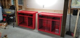

Next was the cabinet base. I priced out metal tubing like a lot of other folks on here have done, but the bill was more than I could stomach. I turned once again to my leftovers pile and found enough pressure treated 2x4s to do the trick.
My garage floor slopes back to front as most do for drainage, so I puzzled a while on how to get the base level. I settled on using spacers to level the platform, then I used a spacer to trace the floor height onto the edge of the platform. After disassembling the individual pieces, I ripped them on the table saw and then put the base back together. This technique worked perfectly.
The tool chests will help hold up the bench top, but the primary support will come from 3/4" plywood salvaged from shipping fixtures for my wife's new office furniture.
A ripped 2x piece of pressure treated board established the correct height along the wall for the back of the bench.
This little spacer will help support the plywood end and protect it from water/fluid damage.
The plywood is also nailed to the 6x6 column.
That's as far as I got. I probably won't get back to it for a while unless I sneak in some week night work. The next two weekends are claimed by SWMBO for setting up furniture and fittings in her new office.

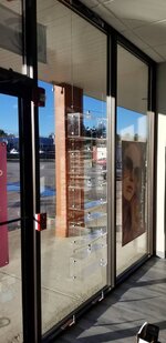

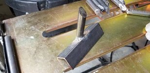

A few activities over the last two weeks...

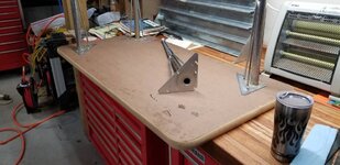

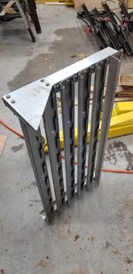

First, SWMBO asked me to install some high-dollar displays in the front window of her new office. The display is a set of clear acrylic boxes attached to cables suspended from the ceiling and tensioned at the floor. With a drop tile ceiling and concrete floors to deal with, I puzzled a while before deciding to weld up some brackets to attach to the aluminum window frames.
Here's the installed display...
...and here's the finished bracket. One thing that's unusual about this display is that power for the LED lights flows down the unshielded steel cables. Apparently, it's okay to expose the public to low-voltage, low current wires. Just to be sure, I licked my fingertips and touched both wires--I felt no significant tingle.
SWMBO had me install just the first one to decide if she liked it. She's not totally thrilled with the shelf (dust shows up very easily), but thinks the front window looks unbalanced without the other one. I agree, so I'll be installing the second shelf in the near future.

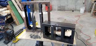

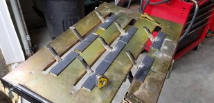

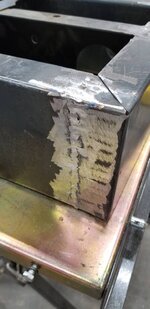

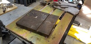

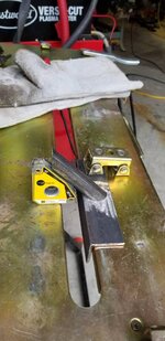

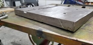

While I had the welder out, I also worked on repairing some folding tables for the church that sponsors our Boy Scout troop. I've had these for a couple of months, so I'm glad to finally get to them.

First step was to cut and fasten the second 3/4" plywood end leg to the far column, with the same type of pressure treated support block underneath. No pictures of that, so below is what it looked like with the second chest emptied out and in place.
This space between the chests will hold a hose reel, if there's enough width (it'll be close).
This space will be storage for long materials. I have a Jack Olsen-esque plan for how to make it accessable. That will probably be quite a bit in the future.

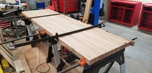

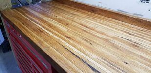

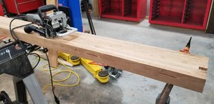

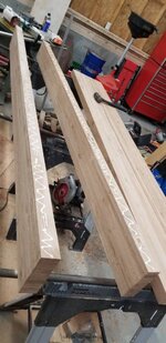

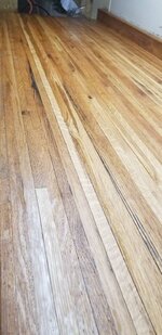

I next turned to gluing the slabs of oak butcherblock together. One of the four ended up with about a half inch warp along its length, so I used one of the other slabs as a straight edge and then straightened the edges very carefully with a circular saw.
With that done, on to bench top assembly. I used the biscuit joiner to help ensure the surfaces of the slabs stayed aligned through the assembly.
After getting the first one in place, I noticed glue was dripping onto the floor from the first seam. Not wanting to waste glue or make a bigger mess than was already there, I prepped the next two and then clamped the whole shebang at once.

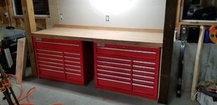

Here's the finished product the next morning. Overall, better than I had feared. There were still a number of gaps between boards, both along the seams as well as already present ones in each slab.
4c2f30235b860bc9d56c2a7a35acccf6.jpgd9549d790140bbaab3b1b2b7d1f4ee31.jpg68360bddc1ab79c69daef69063f8ee79.jpg3967bf717c03ac4e003b9a038cf2803f.jpg
By the end of the day, I had attached a pair of full size fence boards to the back of the slab, notched the front of the slab by 1/2" on either side to clear the two columns and enlisted my visiting daughter and her boyfriend to help me maneuver it into place.
Dead level from left to right. That felt pretty good!
I'm going to add more plywood legs between the two cabinets to support the middle, but I also wanted to help spread the load across the front of the tool chest as well as clean up the gap. I cut two more pieces of oak and glued them to the bottom of the work bench slab.
Finally, I reinstalled the drawers to get a "money shot" for tonight's thread entry. Unfortunately, here's where I discovered my two Harbor Freight 44" tool chests were different part numbers and the drawers were not interchangable between the two. It seems the back drawer lock is in different positions on the double deep drawers and that the slides and slide release locks are mirror imaged. What the means is that you can install all the drawers into the wrong chest and not realize what've you've done until you get to the bottom double deep drawer. No problem, I thought, just pull it out and put it in the other chest. Yeah, this is where the mirrored slides bit me in the ***. The slide retainers don't release properly in this situation and I broke several of them before I realized what was happening and found a way to get them out without breaking the plastic clips. Overall, what should have been a quick install turned into an hour long ordeal. Nevertheless, here's the money shot:

That bench top turned out looking great! Bummer that the tool boxes turned into a bunch of extra time for you, though.

BB: awesome work on your new bench top and your toolbox bench in general. I'm wondering if you might just put on a little wider trim piece on the front of your new bench top to cover the little gap on the top of your toolboxes?
also did you make that little gap/cut on the side for a wire or do tell?

Drives: I did cover the gap above both tool chests with another bit of oak, just like in the second pic. Good eyes spotting the little notch in one end. It was not planned--I just missed getting an eight foot length in one slab by an inch on two boards.
This coming weekend, I hope to get a belt sander on it as well as finish installation and sealing.

I did some more sanding this weekend. Unfortunately, I didn't control the 36-grit belt sander well enough and put some gouges in the work surface. After doing some touch up sanding with 120-grit paper on a vibrating sander, I reminded myself that this was a workbench and not a coffee table. I routered a 1/4" round on the leading edges of the bench and the backsplash. Then, I filled the gaps between boards with saw dust, wiped down the surface with a tack cloth and laid down a thick coating of boiled linseed oil. After making sure it flowed down into the cracks, I waited a few minutes and then wiped off the excess. The color came out a little darker than I really wanted, but not much more. I let it dry overnight and ran my fingers across it this morning.....smooooooth!

I’d do at least 2 more coats of BLO before using the bench. You’ll want it sealed up tight before the weather has it going between expansion/contraction cycles.

BB: looks great from my chair. I might tend to put on a couple more light coats too of BLO and get a little heat on it even if only a lamp/light.

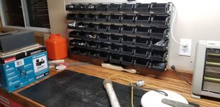

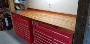

The workbench turned out great and is in service. I'm now out of excuses for not getting things cleaned and not starting using the space. The clutter is a little overwhelming but I was determined to make some progress today and get at least one thing up off the floor. The wall-mounted vacuum canister I scored at a storage sale was the target. The vac did not come with the wall bracket, so I found some 7/16" rod in my stash that fit the upper bracket and cut it to fit between the studs on the back wall. I then notched two scrap 2x4 blocks and nailed them into the studs. The vac dropped right into place and I gave it a test run with the 30-ft hose I bought off Amazon. It worked great! Now, i need to plumb and wire in an outlet that will let me use the remote switch at the end of the hose. Progress!ef6ecb446315958c9a6f2a9775d6840c.jpge3bfbd77c10128b298ebc3240656ed6e.jpg3a97ba68d136108282886ddd87fcbbdf.jpg69451b02b45d4c1888dec3e027b15814.jpgf2b78f6d0436ffd3fcb561f48da24849.jpgc8cbe1966f88662970b3374746036c86.jpg

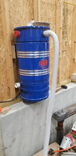

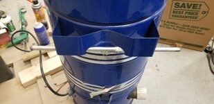

The vacuum is for general purpose duty in the garage, from cleaning up sawdust to vacuuming out the cars I hope the soon be able to get into said garage again.
I plumbed up a formal inlet connection for the hose last weekend. I'll try to get some pics up Saturday.

you have to lift the vac up to dump it out? or does the bottom part open? looks good
Bug, I meant to go grab a picture to help answer your question, but then forgot.
The canister opens at the top, and you lift out a bag to empty it.

Man your work/toolchest bench came out great. I like the glued up top. If it were me I would put a couple of coats of Polyurethane over the BLO once it dries for a couple of days.
Looking forward to seeing the cars in there.

Thanks, Bret. I know poly would better seal up the gaps between the boards, but I'm worried about ruining it if I were ever to get chemicals spilled on it. We'll see--right now it's way too cold to put down polyurethane.

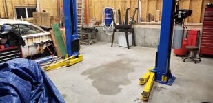

For the last several weeks, I've been walking into the new garage and seeing this:ecdda122fe3b7f208d72db296f98300e.jpg
...a messy garage with junk everywhere. You know it's too cluttered when you've got to turn sideways to move around the building. It was time to clean up.

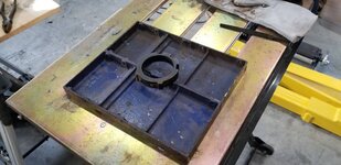

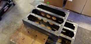

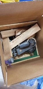

First, I needed to finish the projects that were causing the clutter. This table lost its leg when yours truly lost his balance while unloading it. Turns out the leg of an upside down particle board table will not stop a falling 200-lb man before the screws rip out. So, I drilled new holes for slightly larger, longer screws and got the table back in service.

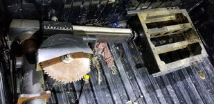

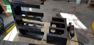

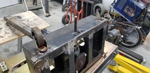

Next, I've been scrapping Craftsman radial arm saws that I bought to turn in for the recall. I found six for between $50 and free around my town and five of them are worth $100 if I send in the motor and carriage to Emerson. However, I decided I could not destroy the beautiful Power Bronze era one. I did, however, marry it up to a base cabinet from the same era that was attached to another saw that didn't match. The cabinet came with a vintage Craftsman wheel kit that's pretty trick. I tuned up the wheel axles, lubing and adjusting the pivots until everything worked smoothly.
I also swapped the bent up front trim piece for a pristine one from another saw. The trim is held in by that looks like a rivet, but it's actually more like a push pin. You can tap it from the back and get it to pop out enough to get a screwdriver under it and finish removing it.

I finished rendering the RAS carcasses, saving bolts, nuts, screws, rods shafts, knobs, and pretty much anything I might want for projects down the road.
For anyone curious about the recall, here's the part of the saw that they want. Once you decide to participate, you order a box from the website (radialarmsawrecall.com) and get this flattened box within a few weeks. Inside is a postage paid return label, two pieces of packaging tape and instructions for how to remove the motor. Once the box is together. I usually put some scrap plywood inside to help prevent any sharp edges from poking through. Once I fill the empty space with whatever debris I have laying around, I seal the box and drop it off at s nearby FedEx store.

SWMBO brought home some glass cabinet doors from her office, so I whipped up some brackets to store them safely in the overhead shelving.

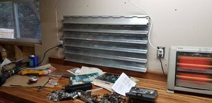

Finally, I installed a parts bin rack I picked at a sale earlier this year. The rack is designed to sit on the workbench surface, but I didn't want to give up that much of my new butcher block. So, I removed the feet and bolted it to the wall. The weight of the rack and whatever its holding is carried on top of the backsplash.0d712e6aa563aca4f5fc49a376142340.jpg27c30242ae052304d5ba0740f30f74a7.jpg68e8d7cb876d5025639da62786b792c4.jpg
Finally, I moved and found homes for everything else cluttering up the floor. Here's how it looked when I closed the door tonight, after two weekends of work.

So, what's a guy to do with all of the parts leftover from scrapping a bunch of Craftsman radial arm saws? Well, I decided to build a stand for the block grinder, using only spare parts I'd picked from sales over the years. After all, what's the point of saving stuff if you don't use it for something?
First, I decided to cut down the table frame to make a base for the stand. I wanted to keep the radial arm structure, to include the functionality to raise and lower the vertical column. I marked and cut it at 9 inches, and then cut the front panel off and then welded it on.
Here you see the base next to an uncut table for comparison.
This project was also a way for me to dust off and improve my welding skills, as I build up the nerve to start repairing rust on my Impala. I used my Eastwood 175 MIG with .035 flux core wire for all of the welding on the project. Some of the welds were better than others. With this relatively thick gauge metal, I managed to lay down some decent beads without blowing too many holes through. Penetration was a little shallow, so I still need to keep working on settings.
I then welded a second column on top of the first to give me the standing height I wanted. I had to trim about three inches off one end of the second column to eliminate a large pair of holes in the side of the column.
For the table top, I reached into the darkness under one of my workbenches and found these two cast saw table extensions for a very early Craftsman table saw. Although I hesitated in repurposing them, I decided 1) they didn't have any real collector value, 2) I was never going to set up the saw and use it myself and 3) they'd probably end up going for scrap one day.
I used the locking collar for the arm as the flange to mount the table to the column. Readers should note that not all years of Craftsman RAS's have a completely circular locking collar. It may be only the early ones do. I cut the central ridge out so I could weld the collar directly to the cast base. The welds seemed to take and stick very well to the cast iron. Unfortunately, I got into a groove and neglected pictures of the welding process.
Here's the trial fit of the table and the grinder to the column. I thought for a bit I might have enough room for my grinder and my Eastwood buffer, but alas, no. I ended up rotating the table 90-degrees from this picture for mounting purposes.
Back on the welding table, I welded up all the side holes and ground off all the surface corrosion. Again, my welds are a work in progress.
Next up was a set of adjustable feet. I reached into the pile of stuff that came with the '57 RAS and found these four feet. I screwed three nuts onto each shaft and then ran a bead down each side to lock the nuts to the base.
I also added two casters on one side to make the stand easier to move around.
After drilling four holes in the top plate to mount the grinder, it was time to bang the table and collar down onto the column. A few taps with the rawhide hammer and...
D'oh!
My welds into the cast iron weren't as deep as I'd thought. Also, I know cast is very hard to weld to if you don't preheat it (I didn't). I took the tabletop back to the welding bench and added some thicker, deeper beads around the collar and along the joint. I also put bolts through two holes along the central spine and snugged them together.
Here it is, mostly done, with the grinder bolted down to the plate.
I say mostly done, because I want to mount a small electric motor to the base to operate the column screw. Overkill, for sure, but I already have a motor, pulleys, wire and buttons. Why not? Then, I'll need to blow it apart and paint everything. More to come later this weekend, I hope.

Here's a shot of the new garage from the second floor of the house. SWMBO and I are cleaning nside this morning, waiting for the sleet and rain to stop before going out the clear the snow later today.b67f453a109b979065ae486c8a537055.jpg
