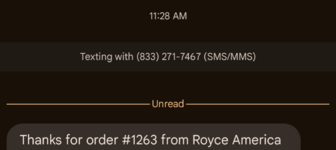

I called and talked to Royce CS, guy named Josh. Super nice guy and actually talked me out of buying multiple blades. He said just to use the one I ordered for everything and if it needs sharpening sooner rather than later then I can consider different styles per application at that time. But he believed it would be fine. He said they will gladly sharpen my Forest TS blade too when the time comes. So far I am impressed with this outfit.
