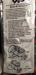

I agree bleeding the master cylinder on the bench.
They make a kit you can easily do this...
Maybe try Schurkey and tlc1976 tricks first.... and if those tricks don't work, pull it!

Took a peek under the hood today. I have a question about master cylinders.
I read somewhere in my web scouring that some master cylinders have a bleed screw.
Not sure if that's true or not, but before I try the bleeding once again making sure the master cylinder is a least level.
I noticed while looking at my master cylinder, and comparing it others I have seen pictures on the web that I have a question.
I took 3 photos of my MC I can see that it has 2 outlets on the fender side going to what must be the ABS unit. One the inboard side I see what looks like a Philips screw in the MS (seemed odd to me), and toward the firewall what looks like a plug. Is this a bleed plug for the MS or just a plugged outlet for some other application?
With regards to MC bleed kits that are available from the local auto parts I noticed that people complained that the kits do not have more than one of each plastic fitting, and I would need 2 one for each outlet. I was thinking I should be able to bench bleed the MS on the vehicle with the kit(s) by having somebody depress the brake pedal slowly ?
I appreciate all your comments.
Probably going to by a MC at my local parts store.
Found 2 online CARQUEST Wearever for $56.99 or Napa for $79.99
Going to head over and by the Carquest Werever.
Turns out none in stock locally. Will try to pick one up out of town Tuesday.
