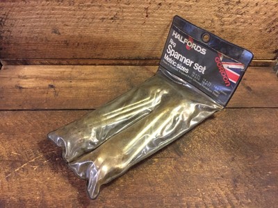

I've noticed that a lot of 'stanley' type blades from various brands sold in the UK are made in England, including some from Stanley. Some are marked Sheffield. Anyone know who the manufacturer is? Assuming one manufacture is making blades for multiple brands.
Happened to spot some British made Halford's spanners on Ebay.
You know they are fairly old metric when the ends are consecutive sized pairs instead of being the common standards run with the odd sizes on others.
Anyway got that set bought as I could do with a set of short metric rings for the machine shop and they are really local to me.

halfords is an auto parts store that sell tools that are mad by others, thy dont make any tools
tools are from the APEX group mostly
29,354
I am assuming then the set posted above labeled "Gordons" was manufactured prior to Halford's beginning to outsource product from Apex, correct?
And the "Halford" thing is strictly a private-label deal, like "Craftsman" was for Sears? (Or "Mastercraft" for Canadian tire?)
dutchgray
Sep 28, 2014
6,469
Dorset. England.
Halford's is a big box store, known for car tat (accessories and service items), automotive tools, bicycles. They do service work and fit stuff to cars now as well. Most big towns have one.
Their tools are private label and they have a pretty good warranty which is why they are liked by many.
They would have had Gordon on the package because Gordon were very well respected and I think a rare source for a Halford's tool but I bet they aren't as nice as actual Gordon's, they sold a lot of Bedford stuff private label as well, also good tools, if a little on the industrial heavy duty side of things.
The Halford's logo on that pouch is 1980 to 87 so that set is quite old.

THIS should then be correct:
Halford / private label brand manufactured for Halford by Gordon, Bedford, Apex, others /
yes?
Sort of.
Originally, I’m talking 1970’s here, Halfords sold tools, but they were not “Halfords“ branded.
They certainly sold Bedford tools in this era, together with things like Stanley screwdrivers. There was some Halfords branded stuff, but as I recall it was things like grease guns not tools. The names of the tool manufacturers were probably better known than Halfords.
I think the Halfords tools appeared maybe late 70’s / early 80’s, and I think that’s the era Mr Lemons tools date from. Note the packaging says both “Halfords”, and “Gordon”, the latter name still counting for something.
From the late 80’s / early 90’s the tools were just marked “Halfords”, and from pretty much that era were generic Taiwanese. They did stock Facom for a bit, but by the time they had added their mark up they were too costly to sell.
