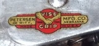

30,038
RE: Petersen Mfg. Co. "Vise-Grip" locking pliers logo:
These older pairs are not stamped, but rather have a decal affixed to them with the "gripping hands" logo:
Petersen Mfg. Co. Vise-Grip No. 7 & No. 9 ca. 1942 (Ebay 282346722616).jpg petersen vise-grip logo.jpg
