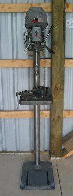

Finally got around to taking some pictures of the Buffalo No. 15 (had my camera in my shop to take pictures of some other stuff to put on Kijiji). I cleaned it up a bit, although there is still some work that could be done to the lower post, as there is some rust outlines still left. Not that bad however and not high on my priority list. Also the motor could use some cleaning. I'm looking for a better vise too. The vise I bought with it is very well made but it is severely beat up, plus it doesn't have a sliding base.

Sweet, that is a really nice press, especially for $160 :drool: Clean? What is there to clean, looks pretty clean from here. :lol_hitti
One bit of advice, loose the MT2 drill chuck and the JT33 to MT2 adapter, purchase a direct mount JT33 drill chuck for that machine. Those extensions were a great idea but terrible in practice. They put way too much load on the little JT33 stub. Delta used the same thing and I have one for my 15" production machine. That press just isn't designed for MT2 tooling. :beer:

Thanks for the positive comments guys! It is in really good shape, works well too. Surprisingly the seller had very little (purchaser) interest despite being in a highly populated area.
I was thinking of converting it to a regular chuck too. I'll have to figure out how to remove the existing set-up. Forgive my lack of knowledge, but what is the idea behind that particular set-up? Is there some type of milling machine type bits that would go where the adaptive jt33 currently is?

That piece just threads off with a spanner wrench. See the hole in the top locking collar? You put a spanner wrench in there and unscrew it. By doing so it pushes the adapter off the JT33 taper.
The MT2 (more taper 2 female socket) taper is common on larger drill presses and machines that can take advantage of MT2 shank drill bits and other large tooling. Mine has/had a tapping head setup in it. That press just isn't beefy enough to use MT2 tooling. You are just adding a long extension that can bend the small JT33 stub underneath.
On that press it goes
JT33 male spindle
JT33 female to MT2 female spindle adapter
MT2 male to JT33? male depends on your chuck
JT33? female on the back side of the chuck.
If you put a taper drift in the oval looking hole on the adapter, the chuck and MT2 adapter will fall out.
One other thing.... A drill press is NOT a milling machine, please do not try to use it as such.

I am aware how the chuck came out, but I appreciate the info on getting the MT2 spindle adapter off. Thanks!
