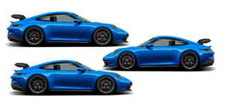

Multiply by three = 150” (minimum)
Thirteen feet is 156” fo reference. Doesn’t seem like a great clearance to me. The ramps on this triple stacker must be 3/8” titanium or there is something else going on.
I'm assuming that the cars aren't directly above one another so that you don't get the full height of each vehicle. Maybe one is backwards and the three noses are stacked above each other? Something like this maybe? It would take up more length, but less height. He menitioned keeping them displayed like art pieces, so I'm guess the lift might have an artistic layout to it. I also am curious for more details just to lighten the subject a bit:)

Here is a picture during construction. The formed garage sits in what was a bedrock hillside. As of today, I don't know if the excavation crew did not go low enough or the foundation crew did not go high enough. I expect the latter as the surveyor set the corners for footings, but at this point can't say for certain as incompetency seems to rule the roost. Finished floor height and finished ceiling height are very clearly called out.
I will chase that answer, but regardless someone other than me screwed up.
To complicate things, in the space between the house and the formed garage there is now a second foundation as well as a 2 story addition. It is about 75% done. This was part of the bigger renovation project. It is not as simple as lifting the garage roof without negatively impacting all this other work that connects the house to the underground garage. (door and window heights, eventual drainage, etc)
Architect did nothing wrong in my opinion. Here is a snap from the stamped drawings. 13' ceiling height is pretty clearly called out as are elevations.
As to the lift, Black300zx kinda nailed it. These are old 911 race cars that barely weight 2200 lbs. The lift was to grab them from one side by the underbody (not below the wheels) and nest all three cars together. This is not a service lift by any means, but rather a glorified storage lift that shows off the vehicles. Imagine three of these working in conjunction, with the cars nested together for display purposes. The lift is built for one specific purpose, so it is not like anyone else really has an interest. A good amount of engineering went into it to make it work safely and as planned.
