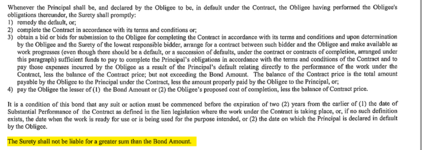

Half-fast eddie
Jul 10, 2021
1,479
Virginia
This says “perform according to the terms in the agreement”. Sounds like lawyer talk, but my lawyer would argue it has to be according to the contract documents ... 13 ft in this case.

The bonding company is obligated to complete the job per plans and specs. Period. If the contractor fails to do this and defaults, the bonding company steps in. That is what the owner paid for. Of course, everything is subject to litigation but I believe that if the job was bonded, the OP would get what he paid for including damages, which could be actual or liquidated depending on the contract.
coldh2o
May 21, 2013
1,452
Ontario, Canada
This is not my experience. Any bonds we see limit the surety to a specific amount (often 100% of the contract amount). The bond wording has been standardized by a few organizations, here's one from the Canadian Construction Documents Committee (principal is the contractor, obligee is the owner, surety is the bonding company):
Regardless of the amount, like any other party involved in the project, the bonding company is not just going to hand over the money. In the specific and very unusual case of the OP's project, if there was a bond the bonding company is going to be at the negotiating table with everyone else.
I agree that a surety's exposure isn't open ended but assuming the bond amount was the value of the original contract (and it usually is), removing and replacing the roof isn't going to exceed the cost of the whole project. Things get complicated fast when a project goes south and you are also right that there are going to be a lot of people at the table.
