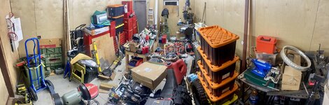

I took Friday off from working in the shop. Saturday was the big move-in day. I was up bright and early, picking up 18 sheets of 5/8 drywall and three sheets of 3/4 plywood for the ceiling. I'm going to cut the plywood into 3" strapping, fasten it over a layer of rigid foam, and hang my drywall from that. I started the day loading the drywall into the second story, which wasn't too bad as I still had a DIY panel hoist from sheathing the roof.
Next up was moving. I don't have many photos from this, just the aftermath, and oh boy. Is it ever a disaster lol.
There is no rhyme or reason here, just piled all my stuff into the shop, and will deal with it later. The good news is that it all fits, and I can envision a final layout that will leave a lot of room open for working. I'm planning on building one of those classic Garage Journal "Steevo" benches around my tool cabinets, and ditching the old workbench currently sitting in the middle of the room. That will be one of the first projects in the shop, I expect.
I also brought my cabinet saw home for the first time, after buying it over a year ago. It's an old Canadian-made General 350, whichy I'll be restoring and building a rolling base for soon. I'll share that project here too.
I'm not going to even think about this stuff until the drywall is done upstairs, though. When it's done, I can move a lot of this upstairs to make room to work.

This has become a recurring problem to be honest. My shop just isn’t big enough (already lol), but it would be so much more useful if I didn’t have motorcycles taking up 25% of the floor space. It would be really, really handy if I could somehow part them upstairs.
Hmm.
I’m not sure how it happened, but a few days after having that though, this followed me home.
So this is the current project on deck. I’m basically building a gantry crane upstairs, with a rolling cable hoist, so I can lift bikes up through the ceiling opening, then roll along the i-beam and drop them on the floor. I don’t have a good way of anchoring the i-beam to the roof ridge beam, so I will be building a steel truss/bracing to support the i-beam from below, anchoring it to the floor framing. This makes it possible to build in pieces, carry upstairs, and assemble. Or also dis-assemble and remove, if I wanted.
The beam is an S6x12.5, 11 feet long. I selected the beam after running through a bunch of load and deflection calculations, and also comparing those results against commercially available gantry crane specs. My heaviest motorcycle is 475lbs, but I probably won’t even use it for that. I'm hoping to sell it ASAP. My main bike is the XR650R, and it's just 300lbs, so this has an enormous margin of safety built in. It should actually be safe for lifting up to 1-ton.
A side benefit is that I can also back my truck through the double doors, and the hoist will be perfectly positioned to lift heavy items out of the truck bed, at which point I can drive out, and lower the carge to the shop floor.
That's it for now. I'm busy finalizing the crane design and will get to cutting and welding next week, I hope. I want to get this crane sorted out sooner rather than later, as the weather is getting warm and it's nearly time to turn my focus to building a paver-stone walkway around the shop.
