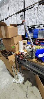

Forks stripped down. Brought the uppers across the shop to cerakote to get done in burnt bronze. AER cartidges and lugs will be here tomorrow. That will drop a few lbs. Ill throw them back together and ship them off to Kreft to have them work their magic.
here are some weights. My old FMF silencer
and the Scalvini. Little bummed on this one because the Ti2 would have been half a pound lighter.
And here is the Keihin
vs the Smartcarb. Im just talking Ls now. Not doing so great at this weight game thing lol
You have a CNC mill, I bet you can take a quarter pound out of that carb. I see a lot of extraneous metal.

lol machinging my own housing for it has crossed my mind but I don't have the time currently. Maybe down the road if I get super ambitious haha
I wouldn’t go that far, just take some off the flanges and corners. I don’t know what internal passages look like, but the big square block on the bottom is just begging to have some speed pockets cut in it.

This was how the fixture looked when I first got it.
Few issues I hit right off the bat. First is the hole for the Buffer tube spring detent needs to be at 6 degrees and there was not as easy way to do that. My initial thoughts were to try to reach thru the magwell on the left side. Kinda like this.
It was definitely do able and honestly I kinda wanted to do it cuz its pretty sweet. But I would need such a long drill and clearances were very very tight. Also no way to put a flat in there for the drill, it was all just to much. I really did not want to mod the fixture at all which is why I wanted to make this work. The much easier option was to just mod the fixture, as I continued on I ended up making quite a few mods anyways.
I tilted the pads on the front side that 6 degrees. There was some toolpaths I was doing on this front side I could move the back, I was also able to easily put a flat in there now for the drill making everything easier.
You can see the modifed one on the right and unmodified on the left.
You can also see I swapped out the bolt clamps for destaco clamps. This was another small grip I had with this fixture. I don't like the bolt clamps because different operators tighten things differently and it has caused consistency issues in the past. The destaco clamps fix that and also make loading/unloading so much faster and easier.
I figured out I can get destaco clamps on a the parts. I have not gotten that far yet but it is the plan.
