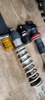

Just picked up this ohlins rear shock. Just a mockup here
It is a larger size then the frame is meant for so I made these Offset bushings that reduce the eye to eye from 200 down to 193.6. The frame is made for 190mm so it barely effects the geometry now and also increases the rear travel by 10% as the oem shock is a 50mm travel and this ohlins is 55mm. So the rear travel gets a boost from 115mm to 127mm, that will pair nicely with the fork once I reduce it to 130 or 140mm

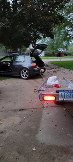

Got a hitch on the gti aswell. The hitch fits like **** and I cant even get all the bolts in. My trailer tongue weight with a bike is only about 50lbs so its fine but I will be fixing it. My buddy is gonna cut it up and we are gonna move the receiver way up so its hidden behind the license plate and then when I want to tow I can just pop the license plate off and the receiver will be there.
I have a higher rise reciever coming in for the time being though. My gti has a tow rating of 3500lbs so it towed this dinky think like it was nothing. My dad gave me this trailer. Overall in good shape but when Im done with this thing its gonna be pimp! Got some cool ideas for it. To start it off the whole thing needed to be rewired and new lights.

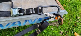

I just picked up these pretty sweet straps. The caribeaners at the end have locks and are hardened steel so cant be cut quite as easily. There is also a steel cable through the whole strap. Little extra peace of mind.

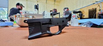

Pistols are getting very close to shooting its first rounds. Its been a lot of trial and error getting internal geometry perfect. It now racks like butter and everything seems to be good. Have some small tweaks and last few things to do and hopefully we can put some rounds through it!
Also have a small company I have been doing some cad work for and am heading down to north carolina tomorrow to set the parts up for production this weekend. Ill be posting some updates of that this weekend.

OP2 is rocking now. Still needs alot of tweaks and adjustments to improve surfice finishes and what not. Overall though its good. Not sure why this pic came out like utter ****. Ill get better ones tomorrow.

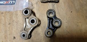

Last week I got some pretty trick parts from Luxon MX. I picked up their rocker and linkage for my bike. The rocker is suppose to make the initial stroke more supple and then add in a little more ramp up through the stroke. The linkage has different inserts to change the eye-to-eye length which effects the seat height. I used the longest inserts to drop the bike as much as I can. It might sound like its a lot but I believe its only like 5-10mm. Something I probably won't even notice, I just want to be able to touch the ground a tiny bit better. Im 5'10" so not really vertically challenged but also not close to being tall. We are heading up north this weekend and wanted to get them installed before hand.
Ignore how nasty my bike is. I need to clean is so bad, just haven't had time. Any free time i've had is when its already dark outside.
Here is the Luxon rocker vs OEM
Linkage and rocker all installed

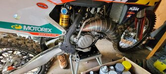

I pulled the gas tank and shrouds as I picked up a larger tank from an XC model and the guy through in some factory edition shrouds for an extra $25. They should be here friday so I got it all ready so I can throw the new stuff on right when it arrives.
You can see I also removed the ignition cover.
I figured I would start the custom parts off for this bike with a billet cover. My design is nothing fancy but little more peace of mind over the oem plastic one.
