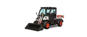

Well after taking the spring months off from building, the North line finally had all the posts installed the weekend of 6/2. Took a grueling two days of essentially hand digging the last 6 line post holes because the post hole auger was not making headway on the sandstone. A rockbar, sharpshooter and physical exertion is what had to be used. Gah it killed me, but dang if I didn't get a solid workout. Eat your heart out crossfitters. Did yall know the 16lb rockbar that feels like 35lbs is actually only 16lbs? I weighed it. Thought for sure it was heavier than 16lbs.
Next I need to get the posts painted before I attach and stretch the woven fence. And I hope to do that in the time I have here and there before going to the East/front section.
Also today, I squared away a rental on a Bobcat Toolcat, post auger attachment and some bits. I took upcoming time off and my plan is to hit the East section and drill all the post holes and get them all set in a matter of days, instead of months. The sandstone is really eating up too much effort and time per post, and that's an area of production that can be upgraded. IMO worth the rental price and I haven't even started yet.
Two-fold, I'm actually using this as an opportunity to check out the Toolcat machine in particular. I initially thought about renting a skidsteer w auger. But for this no left hand situation I have, the joystick controls wouldn't be ideal. I saw the Toolcat, it's configuration and it's specs, and I immediately wanted one. The price tag is up there though. $90k new, $60k used for an unrusted out machine. That's a lot of beans! But spec wise, its up there with a 4 or 5 series tractor, but in a more manageable size and form. It does have it's compromises of course, but it has it's place in the right property.
Anyway, that's the progress. It's getting hot man. I intended to be done in the spring, but the two months off waiting for the bluebonnets and wildflower season really killed my progress working in good weather. But that was my call and I wanted the property to seed out. It's been derelict for years and I wanted it to bloom with desirables to help it's rehab. It is what it is. The Toolcat has AC. Onward.
Monica, is your ranch a business or farm? Reducing your taxes might take some of the sting out of that price. You've already figured out it's a game changer so making your life better is a worthwhile investment.
Bob! I been thinking about you man, hoping you're :)
I do have my business but I rented under personal this time. Yes, the ability to work quicker is good. And finally I'm in the section of property that I can fit a machine in there to help.

Well yesterday I had fun. I went down to the equipment rental place and looked at the Toolcat up close, even got to test drive it. I want this machine! The closest comparison I can make it is to the UTV. The Toolcat started smoothly with the code system (no key), turned on a dime, had quick steering, like power steering on steroids. The visibility around the machine from the operators seat was very clear. I made driving simple, and it was especially helpful reversing. It had better view than the UTV in fact. The loader hydraulics were smooth with the joystick. The 4wheel steering worked great and it felt so weird. My brain was not computing moving in the crabwalk position :lol:
Anyway I'm excited. I'm having them deliver/pick-up it to save me hassle. I opted to rent for a week so I can try it out here and there on the property.
