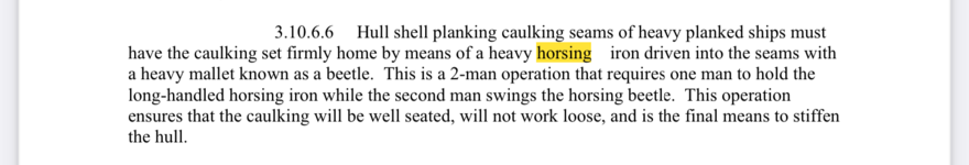

I believe the correct term is a horsing iron for caulking. From an 1873 book.
From Salamans dictionary of woodworking tools 1973 or so
This 1873 can walk you thru the process
1869 naval book
Modern video on FB

Excellent research RTM; with your info was able to locate some decent images of horsing/hawsing irons at:
[https://www.ebay.com/itm/145428042281] &
[https://teddawsonantiquetools.com/products/shipwright-s-26-length-caulking-iron-hawsing]
Perspective: landlocked vs. seaward.

Found a picture of two men using the long handle caulking tool. Page down in the article listed below.
