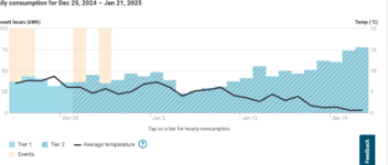

I run my emergency heat ('heat strips') exclusively when i'm away from home in the winter. Gets the job done. When I'm home, I'm burning wood.
My heat pump is ~20yo and won't heat at all when outside temps are below 12°C. It doesn't need the extra wear & tear.
Go on then! What do you think is the impact on your bill?
It goes up.
I get exactly what I pay for.
I left the house Jan 7 when temps were mild. You can see what the outdoor temps did for consumption after that. 9.6kW of air-handler strips in a 1600sqft single-level home.

But seriously the other day when it was 0F outside my 6kW garage heater burned 74kWh so i could get some drywall mudding done. Ironically I'm doing this so i can get my mini split up so it's cheaper to heat, so i can do more with the space.
