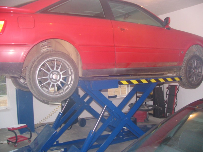

katit
May 5, 2006
862
St. Louis, MO
Few pictures. Lift installed in left bay of 21x20 garage. One picture shows that I can work left side and it's not really bad.

katit
May 5, 2006
862
St. Louis, MO
my ceilings is 9ft high. If you look at last picture - there is raised portion (I did that) so I can lift sedans higher. On pictures car is not all way up
Lift goes up 72 inches, but I won't be able to do that with the car..

BTW, I also have a '93 UrS4...any pictures of yours up on the lift?
Here.. Replaced clutch about 3 weeks ago myself. Sorry for late response as I just came back from vacation

vintagegto said:
Does it lock in lower positions? Is it comfortable to work under? It appears you have access to the entire undercarrage of the vehicle...looks like a real nice lift.
It starts to lock when it reaches about 2-3 ft height and have 12 steps. I lock at 11th as it won't engage on 12th.
Lift has 2 platforms that connected with metal tube. Apparently this tube twists just a little due to the fact that outer ramp raises little slower under load.
You have access to entire undercarriage. In my case I can lift car all way up only when I park backwards and crossmember on a floor right on your way. I had to build plywood platforms to roll transmission jack.
