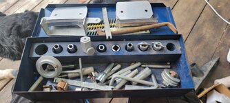

b.martin172
Aug 4, 2024
1
Bought this whole kit at a yard sale....a search of one of the socket numbers brought me here. Based on the above research I have no use for it. Would anyone be interested in it?
