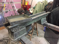

Worked on the lathe tonight. Spent a good 3 hours after work.
First, I continued to clean the spindle and headstock components. Someone decided it would be a good idea to tighten down set screws on the shaft without the included brass plugs. I was able to stone off all of the bad parts and ended up with a nice piece. I will do a final cleaning before assembly.
Next up was removing the name plates. At first I tried to slot the rivet screws with a cutoff and twist them out with a screwdriver. I didn't have much luck with that. Next I used a cold chisel to pry the head of the rivett up. Then I was able to get under the head with a set of small dykes. It really worked well.
e8fb4ce153cf25ebd95f3f3b183de2c3.jpg7b23d86e5ae44f68ba1d74d2e23dcc41.jpgf3a477d70ccb1860ddd740e8fd305719.jpg
After I had them out, I opened up the existing holes with a number 43 drill, and tapped the holes with a 4-40 tap. I would love to have brand new rivets to install, but I didn't want to have to buy a bag of them for just a few tags. I have plenty of 4-40 screws in stock.
I also got a chance to strip the old paint off of the headstock.
Lastly I was able to remove the bed from the cabinet. There I found where all of the mice in my shop were living.
If all goes well I may be able to paint the rest of the machine this weekend.

I also filled the oil in the apron to make sure there were no leaks on my new gasket. Last thing I want is to have to remove it from the lathe and fix a bad gasket.
I also picked up a few thumb screws from McMaster Carr. They are a touch big, but I like the extra leverage. I also went ahead and cut some new brass plugs because again, somebody lost them within the last 50 years.
Tomorrow, I have a friend stopping by to help me mount the cabinet, and the bed.
