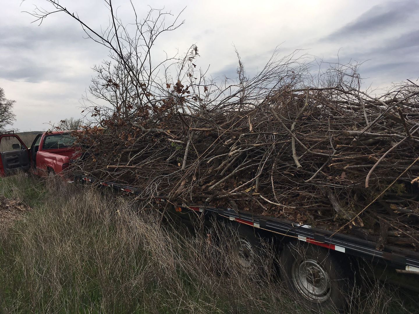

attached photo of the truck and his Buick I did a rust repair and paint on MANY years ago. The clearcoat got buffed thin and evenually needed a redo.
