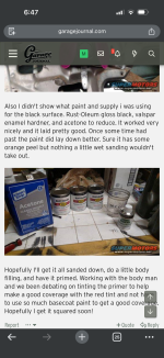

Got the table primed. According to the instructions I have to wait 24 hrs before I can top coat it.
Acetone was used to clean it, and the rest was used to prime. I used hardener to hopefully make it more durable like the Camaro frame when I used the same paint combo. Mineral spirits was to thin the paint. The ratio was 8:1:1 to spray through my harbor freight purple gun.
Hopefully I can spray the top coat tomorrow.

I have a bunch of old pallet racks that I got from Sam‘s Club. The Sam’s was originally a Price Club and all the racks were blue. District manager had all of that stuff replaced in the late 90’s and every morning for a month if you went with a truck or trailer you could have the old stuff for FREE! I’m almost out of my stash but the stuff I still have has spent years outside and is pretty beat up and faded. So before I put it up in the new shop I want to try to paint it RustOleum black, all one color! I’ve picked up a couple purple guns and all the supplies you guys that have done this before recommended. Might go get a couple more just cuz! Must be some more really good deals…. 😂

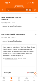

What I got! On the can of RustOleum it calls for thinning with acetone, you ever use acetone?
I don’t think so, I usually follow the instructions and for the primer it said mineral spirits. Checking the paint tds it says the solvent is mineral spirits.
Yet on Home Depot website it says Rustoleum said to thin it with Acetone by 15% for a sprayer.
I have to go back and see what I said to the camaro fender and frame in this thread.
