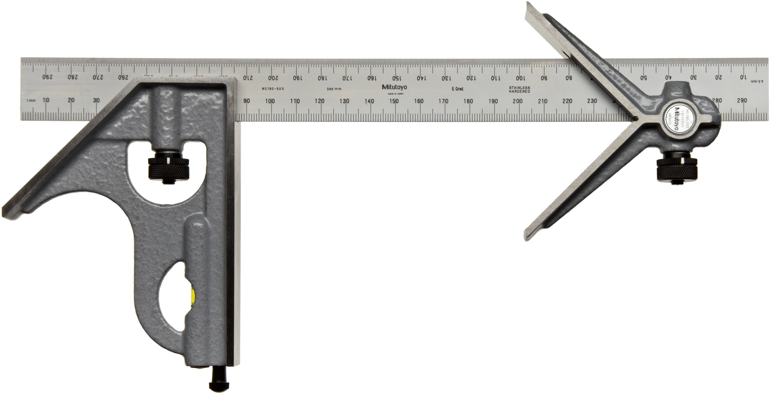

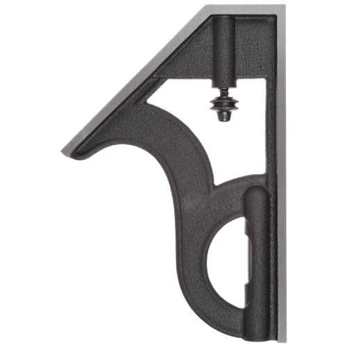

Or, it would be Mitutoyo:
and adding this as well:
What do you guys think ?
If budget wasn't a concern ? I think Mitutoyo will slightly be cheaper...

The graduations on the Starrett rulers are still superior to Mits in my opinion. Starrett satin chrome is the easiest to read rules out there. It's the size of the graduations, depth of marks, etc
The Starrett hardened heads are highly prized for resale. For a new tool, I'm not sure it matters

I would go Mitutoyo.....the 'black crinkle' finish is not going to make the tool any more accurate.

The Mitutoyo is clearly marked made in USA, the Starett is not. I like Starrett a lot because they're still US based, and very local to me to boot, but they've infused their line with quite a bit of China. Just keep that in mind before you pay a premium just for the name and make sure its made somewhere acceptable.

The Mits head shown above is a perfect copy of the Starrett forged head, the Starrett forged heads are smooth gloss black and are considerably more expensive than the cast heads. IF the Starrett pieces are still made in the US I would say buy the Starrett square, as others noted the rules are the difference.
