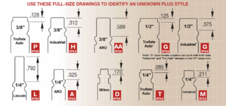

Select 1/4"-body coupler plugs: Milton designations.Compressed_Air_Couplers_01.jpg
Note the huge ID of the Milton "V"/Euro High-Flow coupler plug:
Select 3/8"-body coupler plugs compared to "V"/Euro High Flow:
For the record, Milton "M" couplers are also known as "Industrial Interchange" and are probably the most-common design. The Milton "T" (Tru-Flate) couplers are also known as "Automotive Interchange".
I have, over time, used pretty-much every design of coupler plug/couplers. At this point, all my own air tools have been switched-over to the V/Euro High Flow design in 1/4"-body. I have some larger hoses with 3/8"-body couplers for the 3/4" impact wrench, and adapters to go down to V/Euro High Flow from those 3/8-body couplers, though.

All my plug fittings marked "T" are the size of the P style. Not sure how common that is.
You have Tru-Flate 3/8"-body fittings instead of the more-common 1/4"-body.
I've never seen these before. Is there an advantage to them?
No doubt Lincoln thinks so. As I recall, they were one of the first designs for compressed air couplers/plugs. I worked with them early in my career.
My shop got converted to V/Euro High Flow, and all my air tools got more powerful.

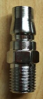

These are my favorite. Takes no effort to insert into the coupler. And its true no one will borrow your air tools.
