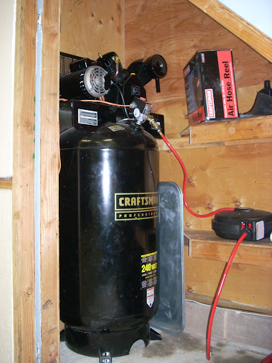

harvey4804
Dec 31, 2009
112
Ramona, California
This isn't mine, it's my Dad's. He had been asking me for advice on buying a compressor, and I found this one at a garage sale for $30. I checked it out, cleaned it, painted it, and had a custom decal made for it, and gave it to him for his birthday. Our last name is Fowler.
It's a 220v Craftsman that runs super quiet and holds air great. I couldn't find a deal like that for myself if I had to. Dad was happy, that's what really matters.
