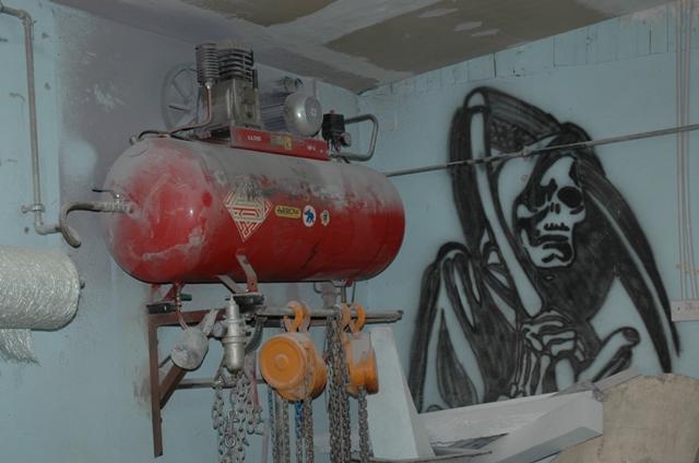

this is my poor italian air compressure 300 ltr. 4hp single face
2 cylenders. I used 3 honda engine mount to avoid any
vibration and also I used hydraulic hose between the compressure
and the steel air pipe's
