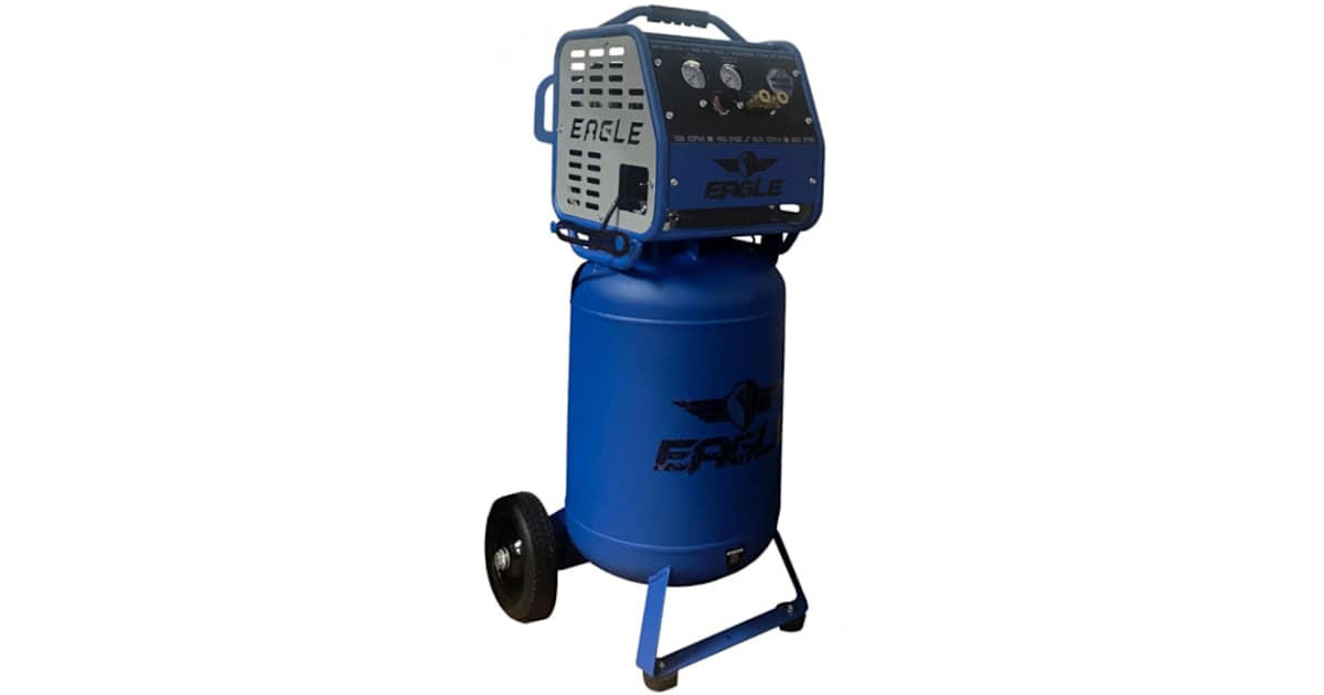

Hey, guys. I apologize for making yet another thread on air compressors, but I'm a bit curious and wanted your advice. I'm looking to get my hands on a 20 or 30 gallon compressor, 110V. I'd like to be able to run a sander, an impact, die grinder, needle scaler, and hammer for enthusiast use, not professional. The ones I've narrowed my search down to are as follows:
https://www.aircompressorsdirect.com/DeWalt-DXCM303.COM-Air-Compressor/p153850.html (Tractor Supply Co. offers one for 600 right now)
I'm under the impression that a higher CFM and a bigger tank are absolutely the most important things to focus on for comps, with noise being a very close second. but I was wondering if 6CFM would be much better than 5, given the same tank size. Aside from that, do any of you have any experience with any of these, or recommendations to steer clear from a particular model? Should I look for a different brand altogether?

I'd opt for the 30 gallon but find the same compressor under a different name for less money, for example: the Menards Masterforce is I believe the same compressor with black paint for $600. And don't set your expectations too high for the sander and probably the grinder, it ain't gonna keep up.

The CAT is a great compressor. That's a tried and tested motor/pump. I've seen the Eagle around for a long time but I've never seen one in person and have never heard about anyone owning one. They're crazy money.
An even cheaper option in the 5ish cfm range with a bigger tank is the 26 gallon Fortress from Harbor freight.
When you're at the point where you're spending $800+ on an oilless, you could spring for the Quincy 12124PQ, or it's vertical variant, or the Napa equivalent, or the Chicago Pneumatic equivalent, Bellaire equivalent, etc.
Those are 24 gallon tank, 7 cfm oil lubricated machines. They're not as quiet as the oilless however.
As others have mentioned, none of these are going to keep up with die grinder, needle scalers, sanders and the like.

Just a few comments. Silent compressors are nice but often the belt drive, oiled compressors can be made less noisy if you setup a decent intake muffler. I have a Campbell Hausfeld made (not branded) belt drive compressor. I saw an 8db drop when going from a basically open air filter (no meaningful noise suppression) to the current factory intake (the kind that looks like a covered pan with a pipe sticking out the side, same as those on the Northern Tool compressor) + about 1.5' of rubber tube slipped over the filter housing inlet.
While the total package is not as quiet as my CAT 5510, it isn't obnoxious even in my small garage. If you are going to push any of these compressors the oil lube models will last longer. Also, I'm not impressed with the way the Eagle compressor is stating it's noise levels... 56db (that's good) at 25ft (well that's a bit more than the standard 1m).
Per https://www.omnicalculator.com/physics/distance-attenuation the sound level at a standard 1m for that compressor would be 74db. Not loud but I think I'm seeing 78db (measured with a phone) with my compressor in the corner of my garage. My CAT claims 60 and shows something like 68 in my garage.
If you are limited to 120V then I would suggest looking for compressors that go to 150+ psi. The difference in usable air in a 175 psi setup vs 125 is really large. I setup a compressor calculator and one of the things I looked at was how many CF of air the system had before the tank pressure dropped to 90 psi. The idea being if you have say a 4 CF tank (30 gallon) how many usable CF of air are in there. So take the peak pressure (say 150 psi) - 90 psi and you have the number of available psi (60). Divide by psi/atmosphere (90 psi/14.7 (psi/atm)=6.2 atm. 6.2atm*4cf means you have the equivalent of 24.8 cf available in that tank. Note: For the engineers out there, yes, I'm totally ignoring the effects of heating/cooling etc and those losses aren't rounding errors.
Anyway, so using my quick metric a 20 gallon, 135 psi tank has 8.18 cf of usable air. The 30 gallon, 200 psi compressor has 30 cf. So if you must drive high demand tools off a 120V compressor at least the higher pressure, larger volume tanks will mean you can go 2-3x as long between pump cycling. However you will also wait longer to refresh.
Finally, all of these compressors are priced near/the same as a 60 gallon, "3 hp" (15-18A, 230V) type compressor. If you can use a 240V compressor you will be much happier as they provide far more flow as well as more tank volume.

Sorry about the delay in response. I'd like to thank all of you for the insights you've offered me, and for steering me away from my somewhat wishful and erroneous thinking. I think I'll hold off until I can either find some cheap used one or move and take a 220V once I can wire an outlet. Cheers, lads.
