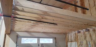

I have a 7 inch by 16 inch 4 ply LVL and wondering what is the best way to connect it to my 8 by 8 inch post. 20220115_152808.jpg

The notch is for the 3 ply 2 by 12 beam that continues over to the wall 8 feet away. That section will be cantilevered.

Always I'd like to see the full assembly setup that way you can cross-connect.
Welded steel is my preference. If you thru-bolt, do so at the neutral axis (vertical centerline of the symmetric cross section).
A part of the question is whether the post has any moment-bearing abilities or its just a pin joint to (or sitting flat on!) the floor.

It is in an 8 by 8 post saddle with a pin into the concrete slab. The concrete slab at that specific point is 3 feet deep and measures 2 feet by 2 feet with plenty of rebar. It was preplanned before slab and rebar was put down

What I suggested above or like a Simpson Strong tie APVT6 should be fine, assuming the other end of mezzanine joists provide lateral stability.
Concur !
I would also add a couple of 4"+ GRKs from each side of the post to insure that it won't split.

Yes. The other 9 feet after the post will have a 3ply 2 by 12 going to the wall. With 2 by 8 cantilevered out 2and half feet . The cantilevered joists will be parallel to the joists attached to the LVL. If that makes any sense. I kinda figured the big Tee from Simpson. But I always look at options as long as they dont affect the structural integrity

So floor joists are hung from side of LVL and sit on top of the triple 2x12? Makes sense. Are the sides of the mezzanine other than along this beam all at walls? Just trying to get sense of lateral stability.

Yes. It's a 30 by 30 square shop. Am building a mezzanine in half of it. One side has 8 foot garage door and otherside has a 12 foot door. Am building mezzanine on the same side as 8 foot door. Click on picture

The floor joists hang off the side of the LVL and attach to wall 14 feet away. The triple 2by12 is an extension of the LVL and that small section will be cantilevered

Forgive me if you have looked at this but the most like failure is the band attached to I studs. The connector is usually only in shear. A couple of lag bolts (showing my age) or structural screws (stronger) in every stud. I would not trust any amount of nails. Probably well detailed and executed already.

2by8 ledger band held to studs with three 4 inch structural screws every foot. My studs are one foot on center

In general, I don't like to see ledger boards "applied" to a stud wall, but I think you have more than enough fasteners !

It looks like the only concern is keeping the beam directly over the post...
Drill a few holes and use vertical dowels. There's no way it's going to lift off. Now it won't drift either.

I still like 2 pcs of 2x8 maybe 24 to 30" long sort of "clamping" both beams and post with structural screws. Looks strong. :) Also hides the gaps. I'd probably chamfer the edges so it looked even more designed.
