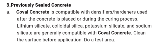

Can you comment on what prep needs to be done before applying after Ghostshield or Formula 137? The TDS for Coval Concrete implies that it might be fine.
Shea
Sep 19, 2012
2,872
California
From my understanding, the No Prep Primer is intended for concrete with such applications. However, I would recommend contacting them directly to verify.
