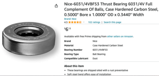

Bearing source;
I located the NICE thrust bearing on Amazon, that's used on the lift....
Ordered 1pc and got 10pcs @ $6.13...Wasn't expecting that...

Wow, NICE deal! Ten of those bearings will go a looooong way.

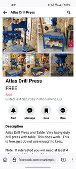

Posting here as I have a feeling someone can ID it faster than me searching. Found part of what I think is a MSA, ideas what it fits and what is missing? Grabbed the closest thing to an pulley arbor I saw.
Edit: Forgot to mention, looks like some Atlas/CM blue under the gray in a few spots.

Yes, that is the base for a Slow-Speed pulley for an Atlas drill press with the sway-back head casting. Missing the bearing shaft and pulley.

Btw, I saw this about 2hrs after it was posted, and by the time a friend asked about it, it had already "sold" to someone.
So somebody in CO got an outer-space level of Vacuum Suckage...
Damn. I felt that from Michigan and wondered what it was.
That's a very cool set-up. That's only the fourth Atlas radial arm I've ever seen in pictures and I bought one of them.

Yeah, between the radial attachment, the table lift, and the fact it had the base from a multi-gang press, it was amazing. I was trying to talk friends into grabbing it for me, when I had left on vacation the day before....
