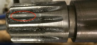

Good day everyone. New member short time follower. Forgive me if I am posting in the wrong area but this seems to be the only active late model craftsman DP thread still active. I just become the owner of a Craftsman 103.0305 DP and I plan on doing a full restoration. So far what I need is the pulley housing cover. Does anyone know where I can find one or have one to sell? I am sure there will be more parts needed. But at this point this is what I know I need for sure till I get the press in my hands.
Craptain
Apr 18, 2013
4,039
Tampa Bay FL
This is a good place to post. That looks like a "Mohawk" dp. Made for just a couple of years in early 40's. I have one and love it. As for the cover you will just have to be patient. Check out ebay, CL etc looking for a parts machine. Or if it is a user rather than a restoration project just make something. It is a relatively lightweight guard and can be damaged easily.

Thank you Captain for the help. I was hoping to restore and be a user. From the video my buddy sent me it purrs like kitten. Just needs some TLC.. I've been reading every single post by you all and it's some serious amount of information that's for sure.. love the fact your all so willing to share knowledge.. hopefully I won't have any issues. The other thing I noticed missing is on the left side of the DP there is a opening that looks like there should be something there and looking at other in comparison it is a circular knob maybe about 1" in diameter. What is it for? See picture attached.
I tried posting on the classifieds for parts but can't untill I reach the magic number 100 post. But will continue to watch eBay and CL. Thanks again sir
39,653
That would be where the Quill retractor assembly goes. If you are lucky one from the later King Sealy DP's will fit? Otherwise a tough part to find unless someone parts out a fairly rare mohawk..
Those were introduced while WWII was raging in Europe, and stopped when the US entered the war... Short run...

That's what I thought it was. Thank you for the confirmation. What year King Sealy DP do you think might fit and with this missing would you consider this DP non operational for use?
Sent from my XT1254 using Tapatalk
That quill return spring design more closely resembles an Atlas spring (like below) than the later King-Seeley machines. That Craftsman model uses a flat, clock-spring style. The King-Seeleys use a 4" coiled torsion spring.
Honestly, if that were mine, missing the cover and spring it would be a part-out machine.

That quill return spring design more closely resembles an Atlas spring than the later King-Seeley machines. That Craftsman model uses a flat, clock-spring style. The King-Seeleys use a 4" coiled torsion spring.
Honestly, if that were mine, missing the cover and spring, it would be a part-out machine.
Dang really!!? Why would that be if you don't mind me asking? I am new to all this so please forgive me.
[IMO]
The return spring is a very important component. That model is very uncommon. IF the spring assembly is unique to that model, it could take a long time to find one. The cover is not functionally required, but completes the machine. The cover IS unique to that model and could also take a long time to find.
Also, less common = more money

Another 10 minutes tonight and I had everything apart. Everything came apart easily despite the heavy handed coat of blue paint. I'll start trying to make it look good now.
One thing I noticed when I had it all apart was that just one tooth on the pinion gear seemed to have excessive wear. Just one. Have you noticed that on any others?
Yes, unfortunately I have seen that before and was not as lucky (or maybe as patient) as you.
That is a very common issue with the pinion gears. That will occur when the pinion gear tooth hits the quill cylinder when it reaches the end of the tooth rack on either the top OR the bottom of the quill. Your picture shows the tooth that hits the bottom of the quill. Look for another tooth with the same (maybe smaller) wear spot on the opposite corner on the fifth tooth clockwise from the one in your picture.

On early machines, the tooth hitting the bottom of the quill may be another effect caused by the feed stop bracket sliding down the quill after many feed cycles. I can see that was the case on your quill and bracket.

I haven't noticed any operational problems with this issue.

Just as you said. 5 teeth over. This one shows significantly less wear. Good to know that it shouldn't effect the operation of the press.
