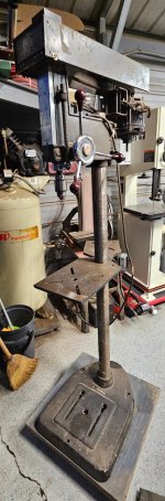

An Emerson Craftsman gen 2 bench top (DP#151). This one is easily in my top 5 of outstanding original-condition machines!
The owners manual, a drill press operation guide and the ORIGINAL sales receipt were included.

I just randomly snagged the floor version of this with the dual tables. $50 Craigslist find, drug it home. I've never seen the dual table deal..I decided I needed it for the base, post and tables.. the rest would just be stripped down for parts for another future project.

DP#152 - Part 6.2, Cleaning the Column
The column has been soaking since early yesterday.
I dumped the citric acid in a bucket and removed the column from the pipe. Here's the column right out of the citric acid. This is normal for the rusty condition.
full
full
I started scrubbing off the rust residue with a Scotch-Brite pad and CA from the bucket. The residue comes off rather easily.
full
Afterward, a rinse with hot water and towel dry. Then a dry rag pushed through the column.
full
full
Believe it or not, it's looking pretty good... another soak is not necessary. It's ready to mount on the lathe.
full
full
I have to mark the location of the weld seam on the outside of the column and orient the seam in the gap between the chuck jaws. Otherwise, the column will spin out of balance.
full
full
full
F
FrankLee
Sep 13, 2010
3,641
seMI, 48317
DP#152 - Part 6.3, Turning the Column
This morning, I poured some used citric acid from yesterday into a jar and heated it the microwave for two minutes. I inserted the column lock shoe and bolt to get that cooking while completing the column. The CA really starts percolating after a few minutes.
full
full
full
full
So here is my lathe set-up. I have two box fans sitting on a saw horse behind the lathe. A piece of used furnace filter is held in place with the fans running on high. The filter does a pretty good job catching the dust. You can see trapped dust from previous uses.
full
full
Below is a start-to-finish video of my cleaning process. I started with 220 grit, then 400 grit, then the 3M ultra-fine pad. That's it, and that's enough for me.
I need to wax it yet, but here's the finished product. Not bad considering the condition it was in.
full
full
full
full
F
FrankLee
Sep 13, 2010
3,641
seMI, 48317
DP#152 - Part 6.4, Installing the Column
I pulled the lock shoe and bolt from the citric acid, rinsed, dried and wire wheeled them.
full
full
full
full
Here's a tip that I learned from @Terra Nova many years ago. Dissolve some paraffin wax in mineral spirits and dip clean steel parts. The mineral spirits will evaporate leaving a nice wax coating. The lock shoe is a perfect candidate for this process.
full
full
I inserted the lock shoe into the base, applied some anti-seize to the bolt and started the bolt into the base.
full
full
full
The next step is to install the column. I applied paste wax to the lower 8" of the column and inserted it into the base. I see no need to buff off the portion of the column inside the base as it will provide additional rust prevention. The column and base are tilted 90 degrees, the column is adjusted so the bottom is flush with its bore in the base. This keeps the column off the bench (or the floor for a floor-standing dp) which can prevent wobbling on an uneven surface. Orient the column with the nicest side forward and tighten the lock bolt.
full
full
full
full
Lastly, finish waxing the upper column and buff.
full
full
full

DP#152 - Part 7.1, The Table
The table and lock were grimy and as rusty as the column.
full
full
full
full
full
For the lock assembly, my first step is to de grease the cylinders with lacquer thinner in the sonic cleaner and the lock handle with steel wool.
full
full
full
full
full
Then, soak overnight in citric acid, rinse and wire wheel. A tube brush through the cylinder bores cleans the inside.
full
full
full
full
full
full
full
full
F
FrankLee
Sep 13, 2010
3,641
seMI, 48317
DP#152 - Part 7.2
The first step for the table is to de-grease the milled surface with mineral spirits and a Scotch-Brite pad. This will prevent sandpaper from getting clogged. I wanted to sand before cleaning because of how rusty the table was.
full
full
full
Next, scrub with Grez-Off. The grime just melts off.
full
full
Rinse, towel dry and re-sand. Then, run a tube brush through the lock bores.
full
full
full
full
Finally, wax and buff.
full
full
F
FrankLee
Sep 13, 2010
3,641
seMI, 48317
DP#152 - Part 7.3
Installation begins with lubricating the lock bores. I sparingly use Super Lube grease.
full
Sometimes I use a cardboard tube over the column before installing the table.
full
full
To prep the lock, I use Super Lube on the lock handle; one drop for the sleeve cylinder and one drop on the threads for the lock cylinder.
full
full
full
The Table Lock
The table lock handle can be installed on either side of the table depending on your preference. I like the handle on the right.
The lock cylinder with threads usually has two bevels. This allows the handle to be oriented in one of two positions 180 degrees apart.
full
My preference for handle orientation is between 1 o'clock and 4 o'clock. I insert the lock cylinder on one side of the table and the lock handle with sleeve cylinder on the other side.
In the photo on the left, the handle landed at the 10 o'clock position. It's too easy to unintentionally knock the handle loose. In the photo on the right, I removed the lock cylinder, rotated it 180 and re-installed the handle. The lock handle now lands at the 4 o'clock position.
full
full
The installation of the table is complete.
full
