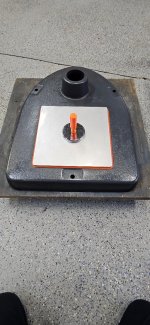

Base cover to keep debris out from under it, snagged an orange handle Craftsman torx driver off of ebay. There were screw driver sets and singles, this one was the least expensive. Didn't know such a thing existed until I started searched for orange and black handle screw drivers.
