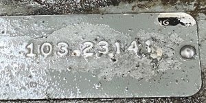

OK so here is the sneak peak! Got the Craftsman 150 w/ table raising mechanism, Early 12" Atlas bandsaw, box of tools and drill bits for... wait for it........:rocker:$210
Of course there are issues my friend wanted the bandsaw so I got the drill press and tools for $110. It's pretty rough and it may become a parts machine I haven't tried to source parts but already I know it needs a motor, motor mount bracket, depth stop nuts, head stop lock and nut, one maroon knob. Then it is covered with a heavy grey tractor paint so lots of work. The table raiser looks to be in excellent shape inside and I think it will clean up well. I am not sure how the bevel gear on the main screw comes out though. I read where its pressed on and saw Franks wonderful pictures where he has it totally disassembled but I couldn't find any discussion on how to get them apart. Anyway it's hot and were are going to eat. More photos later.

Congrats! Even though the drill press itself is rough, overall, it's an excellent find!
With the oval badge and cast handles, that's actually an early 100... probably no later than 1953.
The decision whether you refurbish the drill press or part it out should depend on the condition of the other critical parts; the spindle and the spindle pulley. Replacing parts can get expensive.
I agree... the bevel gears on the lift look great!
The first step to dismantle the gear housing is to remove the two jam nuts. A thin tappet wrench works well for the lower nut. IIRC, the nut is 11/16". Once the jam nuts are removed the main screw should slide out.
Next, retrieve the thrust bearing.
Then, there is a collar with set screw on the outside of the housing attached to the bottom of the sleeve of the bevel gear. Loosen that set screw and remove the collar. Push the bevel gear up into the housing and retrieve.
One more tidbit about dismantling... The pin attaching the crank handle to the shaft is tapered. It will only r&r from one direction. You should be able to spot the ends of the three grooves on one end of the pin.
I just added a bunch of pictures to Part4 of the table lift from dp#76. That should help a bit more.
The bevel gear is pressed onto the main screw only on the head-only lift.

mc4life27
Jul 2, 2014
404
That was a good painting tip!
I think 2nd gen and later Emersons had very similar quills with some design changes.
BUT... below is the quill from dp#87, a 2nd gen Emerson. Notice the gear rack ends about an inch from the top of the quill.
It's difficult to see, but compare to the quills in my quote above. The gear rack in both of those end further down the quills. At the time I wrote that quoted post, I counted the same number of gear rack teeth in all quills from the earliest 100's through the 3rd gen Emersons and documented it as such. I'll need to research this more and find some old pictures.
Is this the 2nd gen your talking about? I don’t remember the part number off of my head but i think it was made in 68 and it was the first year on the style change but it was only offered for two years. After that they went to the one with the skinny belt. It may not look as stylish as the first ones but it was free (took a lot of work to get it where it is now), it’s built like a tank, works great, and I like the longer quill travel. I have added a homemade slow speed pulley set up to it the hearing I have in there now goes so slow to the point to where is almost not even useable it’s that slow. I have like a 7 inch middle pulley. It goes from a 1 3/4 to the 7 and then the stock pulleys from there. It’s one of the tools I will never want to get rid of.
