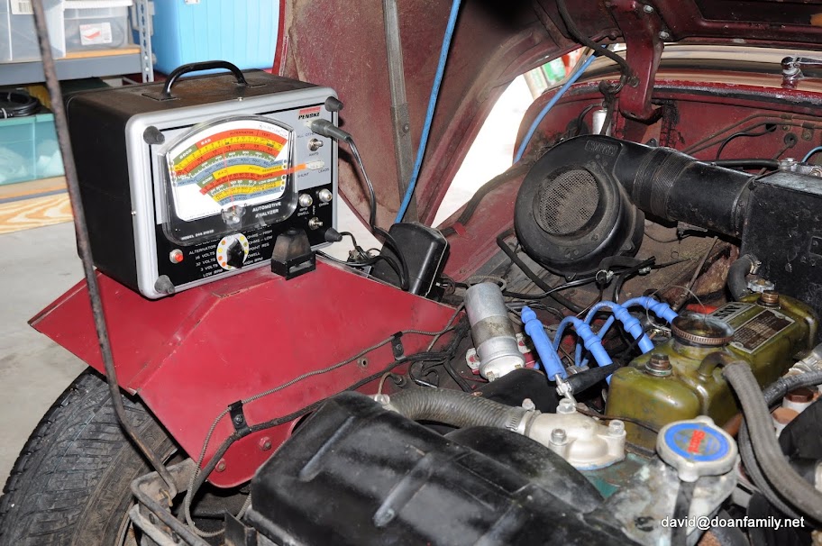

I have my dad's from the 70's. I use it to tune my 59 Austin-Healey Sprite.
