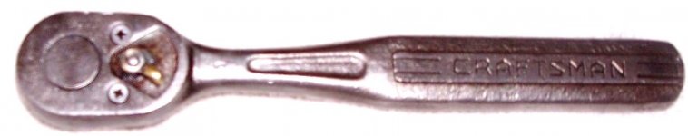

The code is a S upwards towards the selector.
Also does any one know if I can still get a rebuild kit for this ratchet? There is one tooth chipped off.
I wonder if the Wright Cougar ratchet guts would fit that old style craftsman ratchet. The customer service rep from Wright told me that the Cougar tools were outsourced to Kingsley tools /Danaher in Garland Texas. Much of the production from the Springfield MA Moore Drop Forging/EASCO plant was moved there a few years ago.
wrenchr
Jul 29, 2007
11,603
I have access to both and I will try it out and take pics, not today but I will get to it.
