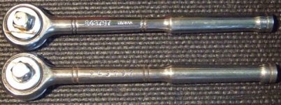

Here are some comparison pictures of the Taiwanese 1/2" ratchet, 43797, alongside the same-numbered [I always assumed was a ] made in USA version which I believe was purchased when I got out of college in 1990, either as a graduation gift or among my first tool purchases.
Hope this helps!

Here are some comparison pictures of the Taiwanese 1/2" ratchet, 43797, alongside the same-numbered made in USA version which I believe was purchased when I got out of college in 1990, either as a graduation gift or among my first tool purchases.
Hope this helps!
Best,
Joel
I had a couple of those ratchets years ago. I don't think the country of origin matters a bit on those, every one regardless the country of origin was complete and utter ****! :pimpflash
billymade
Apr 2, 2008
7,461
New Mexico
I remember those ratchets coming in a zippered vinyl case with a ratchet and socket set all in one. The **** factor was high on those ratchets and they still show up as warranty items at the store.
64merc
Jan 24, 2008
2,816
Texas
Hope this helps!
Best,
Joel
Wow, I've heard of made in Taiwan C-man tools but I've never actually seen any. I'm also suprised to see two different versions of thos tri-wing ratchets. I always thought that since they didn't have a country of origin on them, that they were made overseas, but I now have my doubts. It could have been that they were made in the USA but that they were planning to move it to Taiwan, and in preparation, decided to remove the USA in order to transition the consumer.

I should not have spoken so strongly, I _thought_ mine had been made in USA, but, now, probably have to reassess! Anyway, hope the pics help.
The set came in a blowmold case, 3 ratchets, 4 extensions, 3 sets of sockets, combination wrenches, even 2 spark plug sockets.
Best,
J

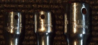

heelsroll,
Thanks for the posts and photos. Your Taiwanese tool set photos have cleared up an issue we had with the E and EE series tools. I think we can now safely say that the E/EE series tools were not manufactured by Easco. And because of the ratchets, we can now reasonably link the E/EE series to Stanley.
Unless someone can provide a persuasive argument that the E/EE series were not made by Stanley, I'm going to update our working list and change the likely manufacturer to Stanley.

Sorry, but you lost me. I can sorta see how you made that determination about the E series, but how did you determine the EE series was made by Stanley as well? Plus, it seems odd to me that the E series was made in Taiwan, but the EE series says Made in the USA. Of course, I'm assuming that the EE series would have come after the E series. I'm going by their past history on this one. (G,G1,G2...)
My pictures were a little unclear, here's a close-up of the extensions showing series EE and Taiwan.
J
Thank you sir, I can see where he was coming from now.
Ok then, playing devil's advocate here, I can see C-man not putting a country of origin on some of their E series stuff to disguise that they were made overseas, but I don't understand why they put Made in the USA on some of their EE series sockets if they were made by Stanley overseas. Is it that part of this series was made by Easco in the USA, and then production of some of the EE series stuff was filled in by Stanley? We all know that C-man contracts different items to different manufacturers, and then even contracts the exact same item to different manufacturers. Bottom line, I'm not ready to rule out another manufacturer besides Stanley.

I, too, have a recently-acquired vintage 1/4" ratchet set. Like you, my ratchet has no "series" marking (just the newish double-line logo), but the sockets in the set are all marked "V". I believe it is from the late 1940s since the sockets are also cold-broached! I have perused a PDF 1949 Mechanics Tools catalogue and my set appears therein; the ratchet looks like mine, but the sockets don't appear to be cold-broached, leading me to believe my set is from 1945-48.
The next catalogue year I have been able to find is 1954. By then, the ratchet is different and so is the box!

I have a V series 1/4 ratchet marked 43175.
Willy
Willy,
Welcome to the black hole of the Craftsman universe. One question for ya: Approximately when did you acquire this ratchet of yours?

Lauver, I was reviewing your list on post #69 (very well done BTW), and it looks like you left off G1 series code. I'd have to confirm, but I'm almost positive that I've seen this on a socket before.
Also, be aware that there is a G code and an upside down G code. I noticed this last night while looking at some sets that I pieced together from pawn shop tool bins. Except for this detail, the sockets look identical.
Lastly, I found a G series socket that is different that the other G series sockets I have. The engraving is much much deeper than the others and the color reminds me of the EE series of sockets. At first I was thinking that there was an EE series and then a "preliminary" G series made from the same basic tooling, but I was mistaken. I compared the strange 18mm G socket to the metric EE sockets and they are totally different. The EE series lacks the band of notches around the bottom, signifying that it is metric. Can I assume that the band was put on their somewhere between the EE series and the G series? Does this finding support my most recent theory of multiple manufacturers/same series code? Just food for thought.

46merc,
Back to your EE chrome sockets; can you post a photo or describe them in a way that would point out how they are substantially different from standard C-man sockets.
I only have a few Stanley sockets to use as a point of reference. The standard grade Stanley sockets (sold at Wal-mart) are pretty much the same general design as C-man Sockets (straignt cylinders, except for the real small ones that are necked down at the business end and of pretty much the same length as C-mans). The Stanley Pro-grade sockets are of a different design, especially the larger sizes, which are necked down at the drive end. The Pro-grade sockets are also significantly shorter than C-man sockets of the same drive and socket size.
If I were buying sockets, I wouldn't give the Stanley standard grade any consideration, their cheap ****! I like the Stanley Pro-grade sockets, they are well made, seem to hold up well, and the shorter length works out to my advantage more often than not.
So, of the two grades of Stanley sockets I've described, and am familier with, which grade sounds the most like your EE's? Or, do you have sockets that are totally different than what I have described?

lauver, I'll see if I can get a couple pics of the sockets in question. It's frustrating because, without getting into too much detail, I'm finding it hard to get anything done in the evenings. By the time I have a chance I'm really tired and it's bed time for me.
I'll have to take a look and let you know if they compare to Stanley sockets. Once again though, all of the USA made Stanley (pro) sockets are different than the Craftsman USA made sockets. They look more like older Husky USA sockets than C-man. I still find it hard to believe that Stanley would make a special run of different sockets just for this EE series. I'll stop guessing though, and see if we can actually do some comparisons. :)
FYI, I have an NOS set of 3/8" drive SAE sockets and Metric sockets with the EE code on them. They are not really sets though I guess, just 8 or so of each. They came on these little plastic strips. I also have some deep sockets that came with them. In the same box were a couple of those unmarked Tri-wing ratchets, which I sold already.
Sorry if I am discussing something that has already been discussed. I got lost a long time ago.
