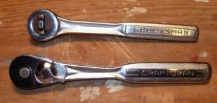

I just found this craftsman ratchet when my mother passed away. I am not a collector and was just going to sell or give it away. Started doing research and got stumped. It is 1/2 in ratchet, one side says craftsman the other says forged in usa but there is a u circled on same side but it is upside down. I can not find another one like this. Is it a misprint or something I have not found. Help please.
ganymede
Nov 29, 2012
2,332
New England
Very sorry for your loss.
Your ratchet was made for Sears by Plomb Tool Company.
Made sometime in the mid to late 40's.
I believe Sears only sold those ratchets for a few years before switching suppliers from Plomb to Moore Drop Forge.
The Moore ratchets were a different design. Yours is not rare but not very common either.
Personally I think it's one of the more desirable rats that Craftsman had offered.

Don't worry; you can't get too badly taken as it will only fetch ~$20-25. Personally, unless you already have a 1/2" ratchet, I think you should hold onto it for the coolness factor.
Someone has had it apart in the past and re-assembled it backwards. The side with the direction-lever ought to be on the side that reads "Craftsman" (although this will not affect function in any way...).
