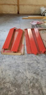

Jayman17
I should have expected you'd spot the stringers. Yes -- they are premade from https://www.fast-stairs.com/.
The kit includes two bottoms of the stringer (pair on the right) and two uppers (that attach to the landing). See photo 1.
In between these two pieces on each stringer is an insert that determines the overall length of the stringers - in my case, the inserts each had two treads. See photo 2.
These are connected together using the connecters at the top of photo 2. Note each has 6 pre-drilled holes that align with the holes on the base and upper pieces. These connectors slide into a channel on the back side of each stringer piece.
Photos 3 and 4 show the close-ups of the final assemblies.
The kit does not come with treads. The kits can not include a center stringer; just left and right. I wanted a 4' wide staircase. The manufacturer said I would need at least 1.5" thick hardwood treads. Neither Home Depot nor Lowes carry that -- both will special order them but there was a significant time delay and even more significant cost.
Solution: I bought 4x butcher block table tops. They are 48" x 36". Each provided 3x threads made of 1.625" thick maple (they advertise them as 1.75" thick but that must be a rough measure). Actually, each tread (aside from the top one) worked out to 44.25" wide cuz they fit inside the stringers.
