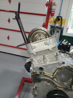

Then laid out all the new engine components to ensure when a friend (retired Jag mechanic) travels to my place from Denver for the technical aspects of laying the crank and installing the timing chain with guides and tensioners that I have everything at hand
  • Pistons with wrist pins, circlips, and rings
  • Cylinder Sleeves
  • Rear Main Seals / Crankshaft spacer and cone
  • Main Saddles and Connecting Rods
  • Oil Pump and Oil Cooler
  • Crankshaft Pulley, balanced Harmonic balancer, bits and pieces
  • Timing Chain, Cam Shaft Gears, chain guides and tensioner
  • Pressure Plate and Clutch
  • Light Weight Flywheel
  • Large and Small Bearing sets

Some bits and pieces
Assembling front suspension; struggling with pressing new bushings into housing
Applied ACF-50 anti-corrosion to blasted aluminum bits to seal porous surface to help shed grease and grime

It has been just over a year since my last posting regarding the restoration of my 72 Jaguar XKE V12 Convertible.
The first few months of the past year I moved forward apace. That is -- until I hit a stumbling block I was unprepared to overcome on my own. When my retired-Jaguar-mechanic friend came to COS from Denver to lay the crankshaft, he also placed the heads in place. May sound easy but each head is secured by 26 studs so getting each head in place requires some finesse.
He had to leave to take care of some errands back home so that left it to me to torque down the heads. Easy-Peasy.
One a Jag V12 block there are 14 major studs placed quite closely to the cylinder holes; they are inserted into the block inside the water jacket. Fortunately, all those took the 52 lb/fts of torque without issue.
The other 14 studs thread into the flange of the block interface with the oil pan (see photo). Two of the adjacent small studs spun in their holes while I applied the torque - both on the same head. SH!T. That was in mid-summer
That resulted in a series of delays and such preventing my buddy from returning to help and several aborted efforts to affect the repair without removing the head.
It is late December and I sill have been unable to link up with my buddy.
So I embarked on a series of efforts to make a pile of bits and pieces into a sub-assembly. In no particular order these are the small assemblies that were assembled. Once the engine / head studs are corrected, the engine can be further assembled, and installed. Once installed, these sub-assemblies can be placed on the car.

Used a pair of zip ties to secure cam gear to chain
Some good news (to counter-balance the bad which I am about to post). When Jeff removed the head, he figured out which sized Time-Serts were needed to make the proper repair.
