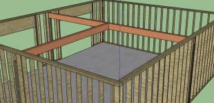

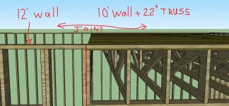

Hi all,
I'm 3 years in on a brand new house, and things are settling down finally to the point where I can address my complete lack of work space.
The main usage of the garage would be for vehicle maintenance, small engine repair, and learning how to weld.
I've moved a fire pit and small oak tree out of the way, so I now have comfortable room for a 34'x28' structure.
It will sit at the back corner of my property, which is roughly a half acre surrounded by a 6 foot privacy fence. I have 14' between the side of the house and the property line, so plenty of room to drive vehicles back there.
So the plan has CHANGED again to 34' wide (eaves) by 28' deep (gable ends), with 10' high walls, topped by a gambrel roof. I'm interested in the engineered roof trusses from barnplans.com
There will be a loft just past the halfway point (18' long spanning the full width of the roof). Structure details are not finalized as far as support for the loft. I would like to eliminate any posts on the ground floor. I want to find out if this is affordable and feasible for a 28' span.
The open side will eventually house a 2 post lift. Tons of room with those trusses.
As for framing, is 2"x6" @ 16 O.C.
5" slab with rebar on 24" centers, chairs, pumped, vapor barrier. Sitting on compacted gravel. (thanks matt)
Roofing will be steel panels, to keep it simple and low-maintenance. Exterior siding hasnt been decided. I will probably drywall the interior, eventually.
1 man door, 2 10'x8' doors
Rough in for a toilet and small sink in the loft
Slop sink downstairs
One drain centered under the lift. Not even sure at this point.
Basic corner staircase to access the attic.
Small cantilevered patio out of the loft? (like Sreno's build)
Compressor tucked under the stairs, with adequate ventilation and access.
Dedicated electrical panel (not sure what size?)
Frame windows ahead of time and cut them out later?
As far as heating/cooling needs, what are your suggestions? It's brutally cold in the winter, and sickeningly humid in the summer. I live just outside Montreal, Quebec.
I was thinking insulated roof, bringing the conditioned envelope right up to the trusses, with an unvented roof. Cellulose sprayed in between sheetrock and roof sheathing? The trusses have plenty of room.
Loft can stay open with a railing or be closed off, eventually.
Adequate ventilation will be important.
Here are a few clumsy sketchup attempts, and some reference pictures of the trusses in question from barnplans.

28x28x16
16foot side walls with scissor trusses. 9ft to the floor on the loft Leaves you with 7foot at the wall and only gets taller from there towards the center.
Im sure a 6/12 pitch steel roof will allow the snow to slide off easily.
Maybe consider condensing the 2 rooms down to 1 corner instead of 1 in each corner and put a staircase up to the loft in the other corner Spanning the 28 feet will require some engineered trusses for the loft aswell.
good luck. Take lots of pictures
bowhuntr311
Aug 3, 2016
135
North Central Minnesota
I'd consider a staircase only if it's tucked out of the way along the northwest corner. I could put the water closet alongside it.
Possibly put your other closet under the stair case? Depending what your keeping in there other than a compressor? Staircase is gonna cause dead space under it anyways. Might aswell try to use it. If your concerned about space possibly a L-shaped stair case with a landing 1/2 down then turn 90 with the rest of the stairs.

Anybody here have an idea for supporting the loft?
All doors would be located on the eave side.
Engineered floor joists?
Steel I-beam or LVL to support the joist carrier?
Sorry if my terminology is off, I'm still studying up on the lingo. I got myself a copy of "Graphic guide to frame construction" by Rob Thallon. I'm still on foundations. Lots to cram.

Alright, I've searched the forum and read up a bit more on finehomebuilding.com, among other sources.
This is what I've come up with, after studying some span tables for LVL beams from Weyerhauser. I'd like to stress that I'm just doing this for design purposes. I want to see what kind of space and how much lumber I'd roughly be working with. Anything I do will be brought to an engineer beforehand. Don't worry.
I don't want the walls any higher than they are.
This is using their "2.0E microllam LVL". 5 1/4" width, 11 1/4" height beams.
The sketchup model is very rough, but it's assuming 2x6" studs @ 16" OC, double top plate, 10' studs.
I checked the span tables for no. 2 SPF 2x12" joists. They would work.
My question now is what is the best way to mount the floor joists? There will be a stairwell in the back corner. Is a 2x12" ledger board lag bolted into the studs sufficient, or are jack studs needed to support the joists?
If the idea is stupid, my apologies.

To answer your question, the LVL guide has information about "minimum bearing length" which could be either top plate or jack stud, depending on how its installed.
I would worry a lot more about the beam-to-beam connection in the "T" shape. To me that says steel-weldment thru bolted to both beams. I think you will see why having a column there is a lower cost option, but at the same time, its not a requirement. Enough structure could easily be built to do what you show above. It will just be more expensive.
So jack studs? Good.
For the beam connection, aren't there top mounted straps and structural fasteners to accomplish this?
If it's all too much expense, I can handle one central post for the floor to bear on. Not the end of the world.
I'm gonna mess around in sketchup some more to design those stairs.
Thanks !
This brings up another question:
Is it acceptable to build the walls shorter where the loft will be, have the joists bear on the exterior walls, then tie them to the taller walls with a top plate?

Alright, no responses so I'm gonna try again.
I modelled my LVL idea with actual lumber dimensions, aside from the garage headers and trimmers, which are a rough approximation.
This model has 10' walls on the "lift bay" side of the shop.
9' walls at the loft side, with 2x12 joists stacked on top with a rim joist. The idea is to cover the gap with the appropriate thickness of plywood flooring, and then another 2x6 top plate. Then, join the 2 wall sections with a double top plate, overlapping at least 4'.
I've been trying hard to find answers about joining a wall of this type, but I honestly haven't seen anything relevant so far. Is it idiotic or could it actually work. I much prefer 10' walls to 12'+ walls, but if 12 is easier, then 12 it will be.
The question stands. Is it doable (and sane?) to join 2 different height walls in this fashion?

Some more tail-chasing...
I modelled the loft with 22" floor trusses, based on a span table I found. The models are just to show outside dimensions. It sure simplifies the design over the LVL setup.
According to the charts, it would be a good deal stiffer too.
Anybody here want to weigh in on I joist vs. 2x12 & LVL vs. floor trusses?
