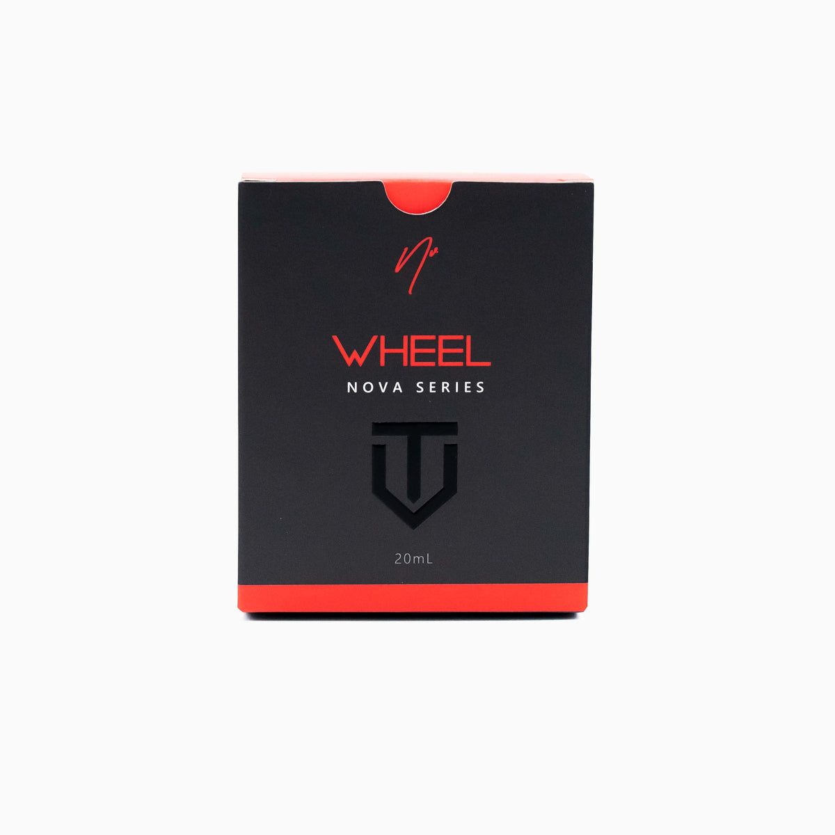

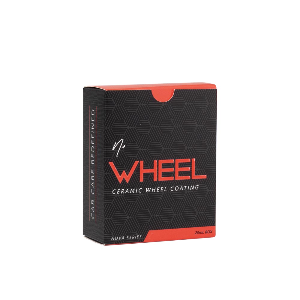

From the very beginning, I knew I wanted to do this right and have the wheels ceramic coated prior to putting them on the car. (Before this, I was using Capro Hydr02 to easily coat wheels, making them easier to clean and dry.) Having brand new wheels, this is the very best time to do this, before they become contaminated with iron from the brakes and general road grime. Coating the wheels is mainly to ensure ease of cleaning, and with super dusty brakes, this is an important factor for me. I will state at this point, apart from applying Carpro DLUX to plastic trim, I had never applied a ceramic coating to paint before. I considered using DLUX again, a dual wheel/plastic coating, but chose to go with NV Wheel instead.
High-temp ceramic wheel coating with 2-year protection. Repels brake dust, enhances gloss & resists harsh cleaners. Rinse clean with no agitation. Shop Now!
www.waxit.com.au
A durable, protective wheel coating that repels dirt, contaminants and heavy grime from sticking to your wheels. Important Note as of January 2021: Due to bottling supply chain constraints, Nova Wheel will be bottled in a 30ml container. Because the product is dispensed as 20ml for full...
nvcarcareusa.com

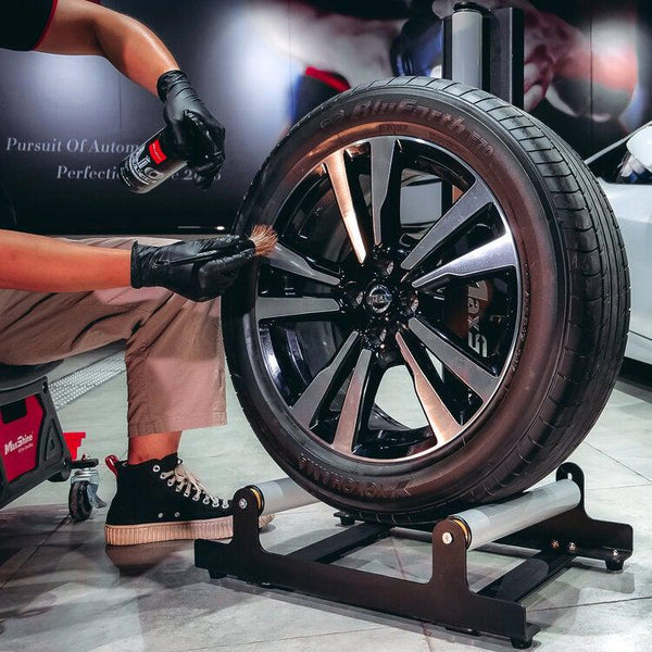

I will also note at this point that when I do something, I go ALL IN. So of course, I just had to have a wheel detailing stand………………
Maxshine Wheel Stand Tyre Roller - for Wheel Coating Cleaning and Polishing The Maxshine Wheel stand is suitable for deep cleaning of wheels, coating and polishing of wheels, and other tyre protection activities. Suitable for use for tyre Coatings, repair, cleaning and polishing.Heavy car and...
detailingshed.com.au

Open the bottle and apply a generous line of the product to the applicator to prime it. Once primed, a few drops are all that is needed. I started using a small round finger applicator before switching to the supplied suede cloth as I was having linting issues with the round one. Working somewhat quickly while showing care to get even coverage, wipe the applicator over the wheel face and spokes. Allow the product to flash, then start wiping with a low pile microfibre towel. Once levelled, take a second towel, and give a final wipe to ensure you have removed all the high spots. Flip the wheel and repeat on the barrel and the back of the spokes. Repeat the process for the three other wheels. NV Wheel is generally fine with one coat but can be layered with a second coat after 45min, but I stuck with just the one.

All up, I used nearly one 30ml bottle of NV Wheel, several suede applicators, and several low pile microfiber towels. It is worth noting that those towels are either destined for the bin or for shop use only, the dried coating in their fibers has rendered them not suitable for painted surfaces again. At a couple of dollars per towel, I'm not worried about this. You will absolutely need some nitrile gloves for this task, and a well-ventilated space.
