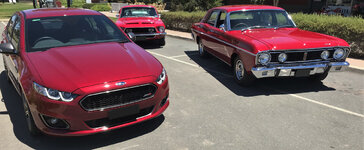

That cat is a very nice car. I had a BF XR6 in a very similar colour.
That would have been Seduce, a beautiful colour that ran from June 2006 on BF and BF MK II Falcon's as well as FG and FG MK II Falcon's up to February 2012, paint code SD. Seduce had such a lovely cherry hue to it in the sun that really popped.
Seduce was then replaced with the slightly darker Emperor which has a gold flake through it. I originally preferred Seduce, having owned my Emperess for nearly 10 years now, I'm more than happy with the color.
Deep, glassiness in the shade................
Vibrant and sparkly in the sun with the aforementioned gold hue......................
Parked here next its older sister, an XT GT in Candy Apple Red.................
Sorry for the overload, color is one of my favorite things about cars. I may also have a database of Falcon/Fairlane/FPV colors.

Seduce! Yeah that's it. i was trying to remember what it was called when I made my earlier post.
That XT GT is nice but never mind that, what's the story with the '68 Shelby behind? The real deal or a replica?
I'm pretty sure it's the real deal. The car is owned by a local businessman who owns and directs the M.O.V.E motoring museum. It's been on display there on and off over the years, a complete contrast to his daily driver Tesla Model S.
Personally, I prefer the OG earlier Mustang's over that body style, especially in Hardtop rather than Fastback.
