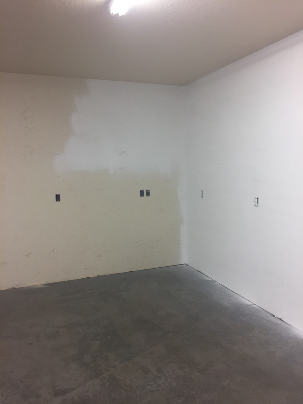

OSB on the walls of my shop, not exactly sure how old it is but the walls had yellowed, I suspect from a Kilz primer coat without a topcoat. Repainted the walls a couple of months ago, added a little color and I'm happy.
Yep, oil based Kilz will yellow slowly overtime if you don't top coat it. I found out the hard way myself.
