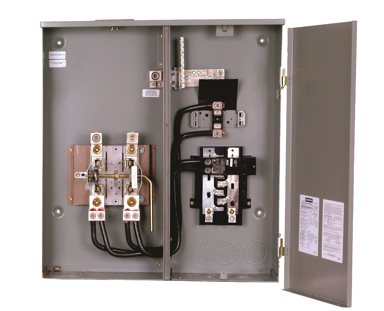

It appears and I an only say "appears" because we have no idea where those wires com from or go to, the second panel is an incredibly expensive disconnect with 2 breaker in series (more wasted money) for you out building.
You meter "pan" (base) has 2 outlet.
If it were my house, I would remove the second panel (a.k.a. "load center" or "breaker box") and wire from the meter base. I am GUESSING that the output of the second breaker goes to the the 90° pulling elbow (a.k.a. LB) that goes down into the ground and who know where. Save this because you will use it when you build you out building.
You could move this breaker and wire to you main load center, but this would only give you 200A service for house and outbuilding COMBINED.
We have to see inside the meter base to see what other options you have. ASSUMING there are TWO fused/breaker disconnects coming off the base (likely), the second one should run straight to the out building to give you your TRUE 400A split 200A/200A service.
Of course, none of this has anything to do with the generator hook up.

Hey Sparkies, I know it is practice, but it seem illogical that the customer owned meter base ids "sealed" by the POCO especially if there is any kind of disconnect in there !
The panel is being used as a disconnect, it simply has the 200 amp main and a subfeed block, code requires disconnects to be grouped so this is how they did it. To add a generator interlock the subfeed block would need to be dropped down a couple of spaces, may or may not have enough slack in the wires to move it.
There will be no means of disconnect in that meter base, the panels on the inside of the garage are the first point of disconnect.
checkthisout
Sep 5, 2008
5,232
After actually looking at the pictures *cough*.
You can use an interlock kit on that panel that's being used as the house disconnect. Just install the backfeed breaker in there, buts out the 2 knockouts and add the inlet and done.
That's pretty nice actually. He used an empty breaker panel for the 200 amp disconnect instead of regular 200 amp switch.

ok so we have determined that i can put an interlock on the bare panel in the garage and that will feed into the house correct?
so now the question is this... does this interlock act like my old 200amp transfer switch? meaning i can just run whatever i want until the genset stalls?
why do the sub feed blacks need moved down? is that the wires below and to the right of the main i assume?
Obviously because it can not opened by the costumer (why didn't I think of that before !)
I know they make meter bases that are split in two so there IS a disconnect for each out going feed.
EDIT : Siemens MC0816B1400RLTM
You do need to purchase the second 200A breaker for the top 2 space opening.
Yes. You may need to move the wires that are connected to the bus down a couple spaces though.
