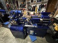

The lathe is a war machine. So a combination of metals. Some of them are cast iron and have the factory chrome still in tact. It’s all of the pot metal ones that need to be plated along with a few aluminum detail parts I made for it.
I’ve done a very complete and detailed restoration of the lathe, and am down to the cosmetic work on the controls. So don’t want to do it half ***. This machine was used at the 300 area of Hanford in ‘44 to build fuel rod containers for the atom bomb.
Can't help with the plating, but that thing is stunning...
