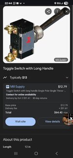

OH........Do you have a Link for those switches ? They might be my answer to a set up for my dual soft-starts on my AC unit.
I want to Isolate the Capacitors when the generator is in use.
