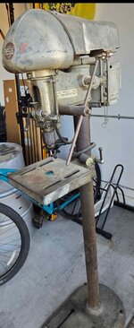

First post but long time lurker. I'm looking at picking up a drill press to replace my current pos 5 speed benchtop hf special, and 2 of them nearby have really caught my eye, but I admittedly know very little about older power tools. I am a hobbyist knife maker, and tend to fabricate bracketry, and other odds and ends for my cars, boat or projects around the house so i tend to work witha lot of sheet metal and tool steel barstock, so I'm assuming If I go with the craftsman, I'll add the jziggy slow speed pulley.
The delta already has a slow speed pulley setup, but needs at minimum a start capacitor for the motor as it has to be started by hand.
i am looking at the older vintage presses mainly due to the look my wife and I are going for in the garage, and I feel that 9 times out of 10 old tools are built far better than similarly priced newer pieces.
I'd love to hear your opinions of the two presses and which you think would be the better long term option for restoration and use.

I have zero experience with Delta and a ton of experience with Craftsman, so I can't really give a comparison between the two.
I do believe the Deltas are a step up towards industrial quality and Craftsmans were sold as home shop use. I also suspect that many more Craftsman drill presses were sold than Delta.
I can say that Craftsman uses readily-available bearings and used parts are relatively easy to get. My biased opinion is that Craftsman drill presses are easy to refurbish.
I don't think you can beat King-Seeley Craftsman on retro looks.
I think that either machine will fulfill your needs.

I would choose the machine that's in the best overall condition. They are both excellent vintage 15" machines. One disadvantage of the DP200 is that I believe it uses proprietary ball bearings and any machine from that era should have the bearings rebuilt or replaced. I would look into that.
I'm a fan of the 17" Delta DP600s and would include that in your search along with the CM 150's. Condition is everything.

Both machines can be had right at $100. With the delta needing motor work. It will put them close enough in price that I'm not going to concern myself too much with it.
They do use proprietary bearings and they are NLA.
However if one has a lathe you can take a 5000 series bearing(exact one escapes me at the moment) and machine a sleeve that is green loctite to the inner race and is functionally the same
If you don’t have a lathe then you can purchase them from several vendors already done.
This is the one off the top of my head
http://www.hammerscale.com/HTML/Products/DrillPress/DP220B.html
I haven’t used them as I made my own. I am partial to the DP220 obviously

Do you have any links or photos of those machines? There may be some noticeable pros and cons.

That 100 is very likely a '52-'53. Those did not come equipped with a head trim panel or chrome plated parts. It was obviously repainted poorly. It's nothing special. The table surface is nicer than the Delta.
I'm a Craftsman guy, but I'd advise to go with the Delta with the belt cover and slow-speed pulley. Regardless, you still need to assess condition, especially runout.
It looks like the Delta has an external capacitor which would be very easy to replace, The old cap should have the specs printed on it somewhere. I use Airstar Supply for replacement caps. They are USA made, reasonably priced with free shipping.

I agree. Get the Delta. It looks original and in pretty good shape. Stripping the paint off that CM would be a miserable job and reflective of other "half ***" repairs/modifications from the previous owner.
If you get a good deal based on a dead motor, take the savings and get a 3 phase motor and VFD.
That style belt guard is very scarce.

I have rebuilt and own both DP's, (I also have Walker Turners) that Delta DP220 has the low speed attachment already, that is your best investment. The bearings on a delta are special, like the Walker Turners, but there is a seller on Ebay I have used that has direct replacements at a reasonable price. I personally like them both for different reasons. I have a sentimental attachment to Craftsman's. but the delta is, as Frank Lee mentioned, is a step up towards industrial quality. Y you can swap low speed and high speed spindle pulleys on a delta, but not the craftsman and you can easily convert the delta to a three handle quill from by swapping it for one off of a 17" delta which bolts right on, (they sell these on ebay all the time in the 50 dollar range). Other than it already having a low speed attachment, you will be happy with either. I will say, and others like Frank lee can attest, that the rust on those columns is going to make disassembly interesting, but not impossible. My suggestion, buy them both :)

I'm definitely leaning towards the delta. This craftsman 150 popped up as well. It looks to be missing a handle, and I believe the 150 does not have the tilting table.
I'll probably go grab that Delta today

Just grabbed it for $85! Start capacitor is definitely the issue, grabbing a new one on the way home, bearings, Pulleys and everything else look great

Definitely not a full rest, but I'm going to get it cleaned up, stripped, painted, change the feed handle to a three handle version and put it to work.
I may fill the arc of shame with my welder and go have the table ground flat.
Down the road, I may try to build a table lift mechanism for it

I'd think twice about filling an arch of shame with a welder. Some guys have indicated it can crack the cast iron table. Do some research first. The images of the table don't look too bad. I'd go the JB Weld route.

Well ****, I got it home and one thing led to another, now it's completely torn apart on my work bench. I'm going to build a "poor man's lathe" with casters and a drill to polish the column, along with polishing all the hardware and handles, painting the covers and tables, and making knobs for the feed handles
It's missing one handle for the head which I'll need to replace, along with the depth stop nut, and after getting into it, the bearings appear to be original and will need replaced eventually, although there's no detectable play.
Does anyone have any suggestions for how to increase the contrast of the depth measurements on the quill? The patina on mine, makes the numbers fairly difficult to see from most angles.

I know some guys make a lathe setup to polish the column but I use 1" wide sanding strips that are sold in a roll and wrap a 2-3' strip around the column and just pull it back and forth from top to bottom. Start with 80 grit. Once you get past 150 grit you can use regular sandpaper and then scotch brite and finally metal polish. Protect the column with paste wax.
Need images of your depth scale. Is the scale engraved on the quill? If so, just polish the quill to around 600 grit and then brush on some paint to cover the engraved area. After the paint dries sand it. The remaining paint will stay in the recessed/engraved numbers. Pick the paint color to maximize contrast.
