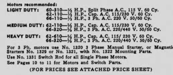

So I've got the entire press disassembled, the cast iron parts (minus the head because I don't want to damage the labels) are in an electrolysis bath. After replacing the start capacitor, I found that the motor that came with it needed bearings and other work. I just picked up a 1.5hp dayton 56 frame for $60 to replace it.
From what I see in the Delta catalog, the largest recommended motor had a 1/2 hp Rating. 1.5hp will potential damage your drill press should a drill bit grab, etc. - especially with the low speed extea pulley option.
Sorry but I don't see a scenario where a stuck drill bit can damage the DP. Drill bits can get stuck all the time and when that happens they usually slip in the chuck or cause the belt to slip in the pulley.
The Delta catalog probably listed 1/2 HP as the largest they offered. Anything higher is just overkill for that model DP.
With modern horsepower inflation in place, is 1-1/2 hp really more than a vintage 1/2 hp? I mean, my shop vac claims 6hp.

Sorry, I have damaged an Atlas drill press with the factory slow speed add-on pulley with a 1/2hp motor stuck drilling steel with a the drill press at its lowest speed. It damaged the spindle pulley to spindle interface. I was rather annoyed and I would have not expected that either.
There is a lot of that inflation going around.😁
In this case, the motor current does look in the ballpark of what I would expect for a 1.5hp motor

It's a bit light. The original 1/2hp drew 7.8 @ 115, so the draw is a little less than double. I'd assume the new motor makes around 3/4 to 1 hp
1 HP = 745 watts. It looks like the Dayton motor really is 1.5 HP.
The old Delta motor looks to be close to 1 HP at 7.8 running amps. They probably spec'd them way more conservatively back then.
It was our good friends at Sears that brought us modern/exaggerated HP ratings intended to defraud the consumer.

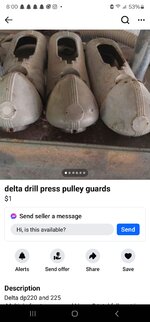

Also, not sure if anyone here needs one, but someone near me has 3 of the pulley guards for sale.
