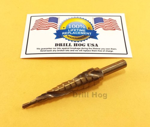

Does this step drill have enough range for your needs?

Step bits and rotabroaches are made for this, though the rotabroaches are usually in the 5/16 and up area. A decent step bit you can buy in multiple (14) size configs are TEMO on Amazon.

I think the step bits will solve the problem, I just wasn't aware they came in the skinny sizes down to 1/8.

I don't think step drills were invented for a machine shop; more for electricians and hvac guys (not to mention all of us) that need to drill thin material by enlarging holes. They're easy to gage depth with a sharpie or some tape. Or, buy one whose largest hole is the size you need.
I agree they aren't right for everything, but I've had great success using them where, like the OP, a drill grabbing can tear out/deform material.

One advantage of the step bit I take advantage of is the ability to use the start of the next step to deburr the hole I just drilled. May not be the proper way, but it works for me.

Step bits will change your entire work flow
and the nice thing about them is even the cheap ones produce good results. The best I've used are Lennox but even the HF and Amazon specials are fine.
